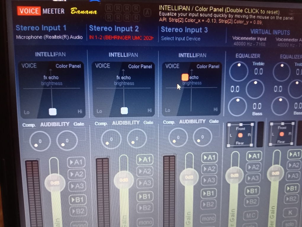

I'm working on it.
Can you tell me why I cannot connect my audio interface in VM Banana (pls see stereo input 2, here below)?
Actually doing my previous tests on VM standard that was not an issue at all, but yesterday it simply did not work...
- IMG_20240313_212723_resized_20240314_083642500.jpg (382.36 KiB) Viewed 30488 times
- Posts: 2184
Re: guitar lessons via Skype: how to set VoiceMeeter
maybe because used somewhere else. did you selected it as output A1 ? with its ASIO driver ?

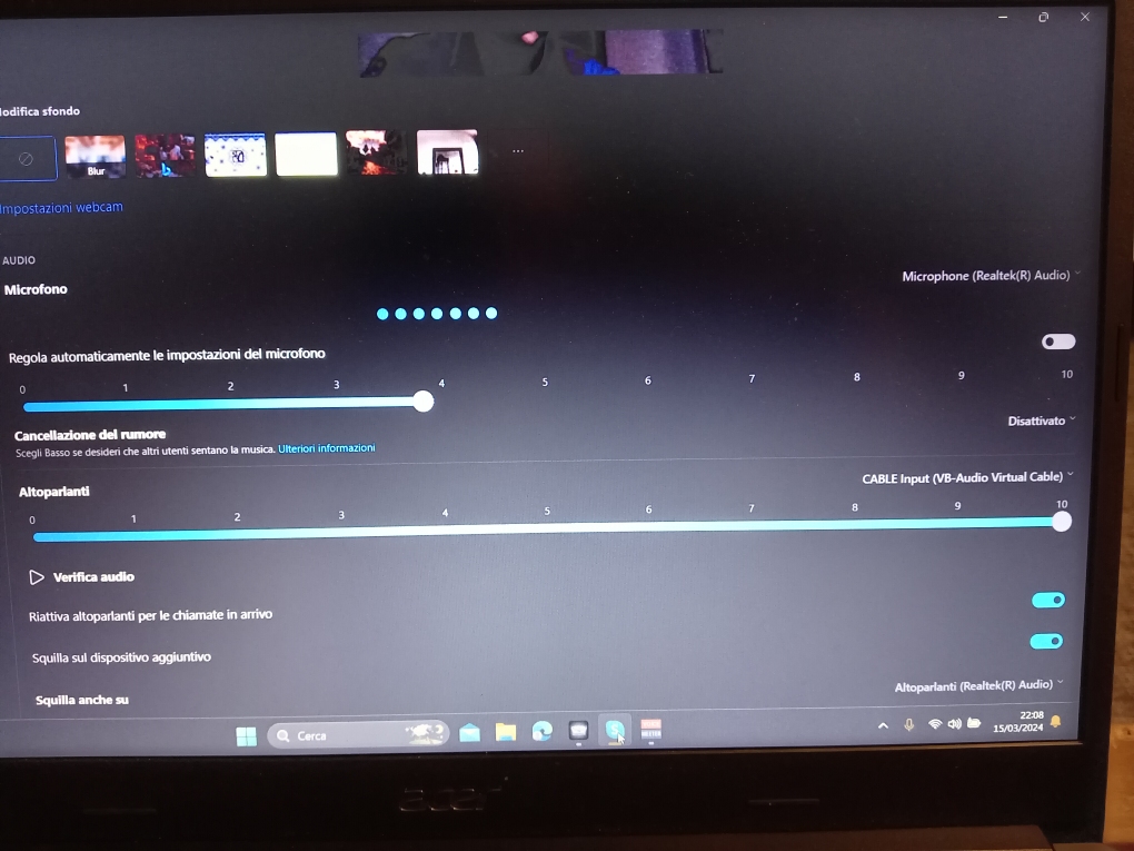

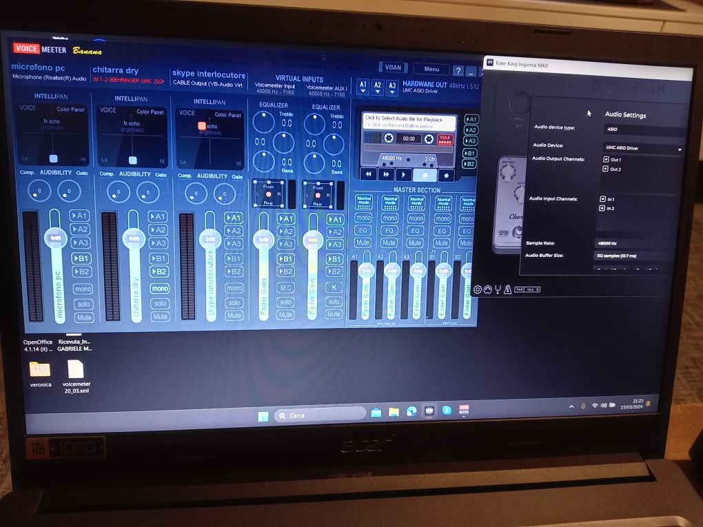

this is my current configuration.
I can hear everything in my earphones (guitar, plugin, backtrack) but my interlocutore can't hear anything.
Can you help?

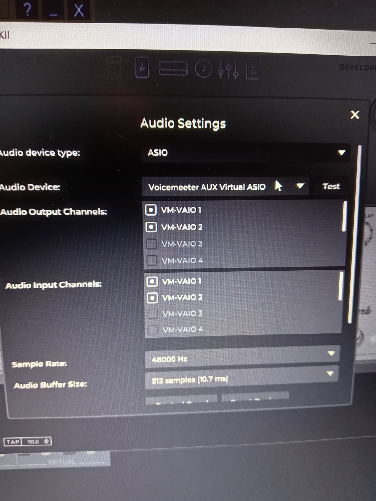

Remarks: in plugin, if I select VoiceMeter on output channel, I cannot hear the plugin effects. To hear plugin effects I must select Asio driver.
