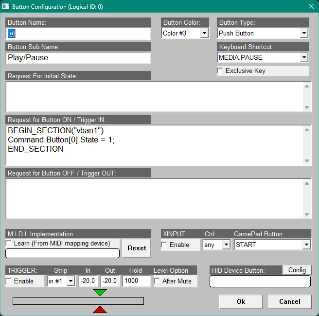

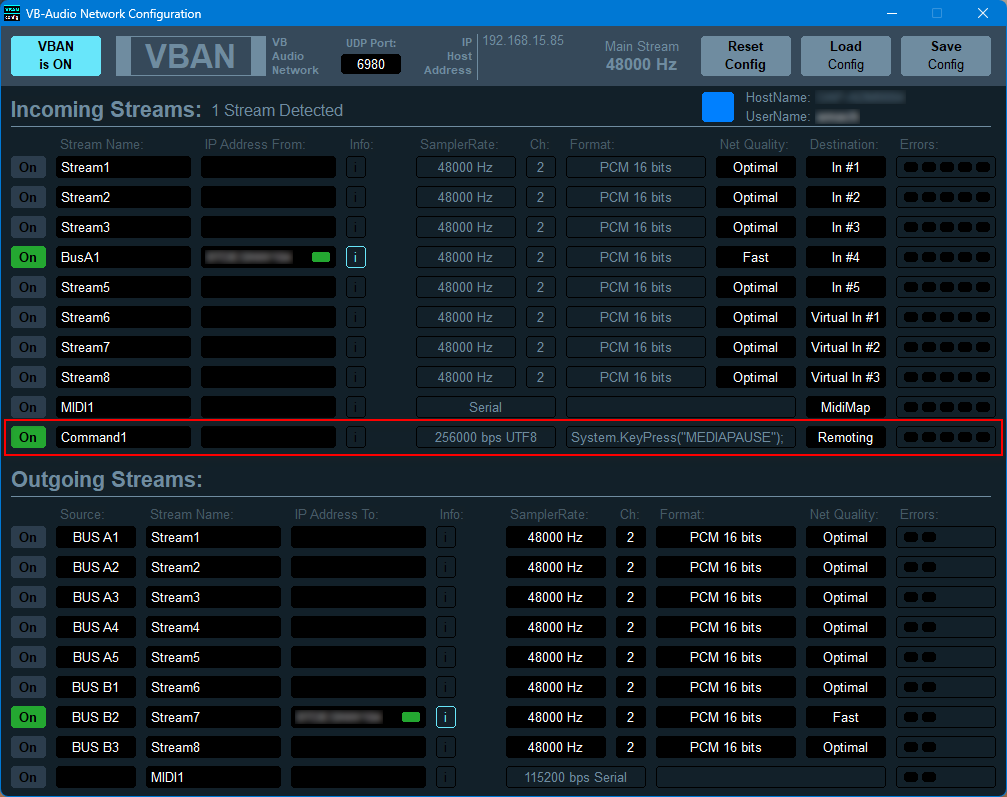

I was able to set up MacroButtons and VBAN, and the target machine is receiving the command, as seen in the screenshot below.
But the music isn't paused in the target machine… Was it expected to work when that command is printed in VBAN window, or may there be anything else to set up?

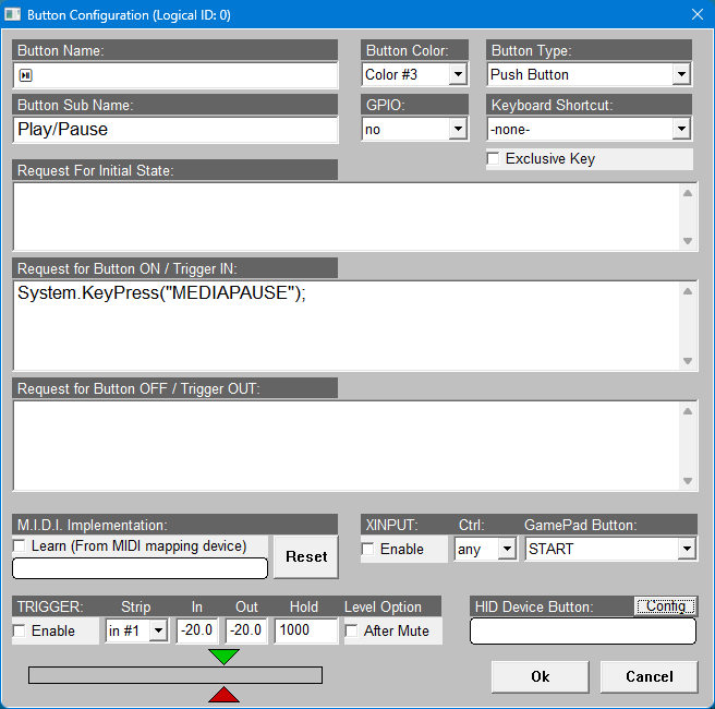

Ok, I've set it up as you instructed.
This is the button setting in the source machine: This is how I've set up the button in the target machine: When I click the button directly in the target machine, it pauses/plays the music as expected, and the button state is reset to off (because of the PUSH mode).
But when I press the button in the source machine and it sends the command to the target machine, the System.KeyPress doesn't occur and the button in the target machine remains in "pressed" state (as if it was configured as a "2 Positions" button): I've tried to add a "Command.Button[0].State = 0;" command after the "State = 1", and it makes the target machine button to go back to "unpressed" state (resembling the "PUSH" behavior), but the System.KeyPress still doesn't occur. I've also tried to move the System.KeyPress script from the "Button ON" request to the "Button OFF" request, but it yielded the same results. Also the same using "StateOnly" or "Trigger".

Ok, I've found out what is going on. When I'm in the remote session with full screen, almost all keys are forwarded to the remote machine, including MEDIAPLAY. So, if I click the MacroButton (or press the MEDIAPLAY shortcut to it) in the remote computer, it runs the script to send the command to my host machine, which in turn runs the System.KeyPress("MEDIAPLAY") script, but this keypress is forwarded again to the remote machine… I can confirm it if I exit full screen from remote session, since that will stop forwarding several keys, including MEDIAPLAY; so, in this scenario, the MacroButtons work as expected, I can click the button and it will play/pause the music, but I can't press MEDIAPLAY key in the remote machine, since it is not being forwarded and executes right in the host machine.arfmach wrote: ↑Mon Feb 12, 2024 7:38 pm Ok, I've set it up as you instructed.

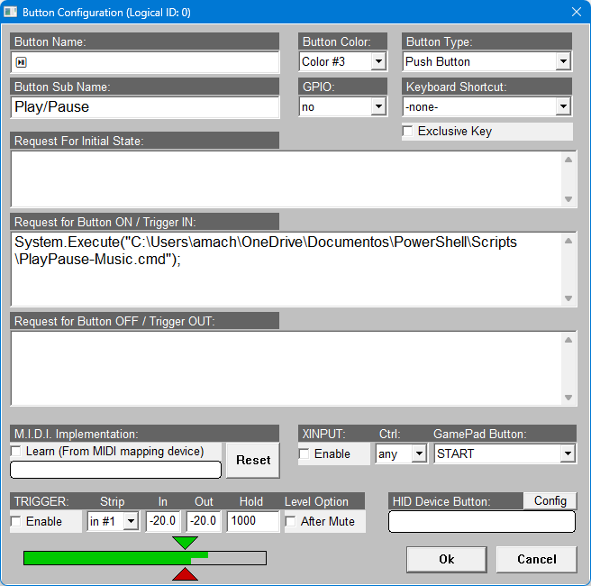

Well, I've finally managed to make it work! It needed some scripting (PowerShell), but at least it works.
This is the new setting of the button in the target machine (host): This is the cmd script:
And this is the PowerShell script:
The "keybd_event" does not forward the key to the Remote Desktop session, so it is always executed locally in the host machine.
The only complaint is that it opens a visible cmd.exe window (which vanishes after script execution finishes), so it would be GREAT if I could configure System.Execute() to run the window in a minimized state…
