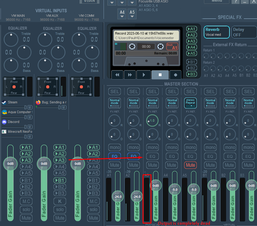

If theres any attempt to use the reverb feature to any output channel, it immediately nukes the audio in that channel, completely blanking it with no sound whatsoever even after removing the mix, the mix must be removed and then the audio engine restarted again

Version is 3.1.1.1
Example, main output A3 has a source sending audio and thus should normally have audio present, but with the reverb FX enabled and a return value set, the audio gets completely blanked, nothing at all is present and comes out, basically identical to being muted. Inversely, the audio is normal if theres a return value set but the FX is disabled (OFF), or if theres simply no mix value, the mix value can be *anything* as long as its not 0.
In addition I have further discovered that this nukes output channels pernamently if EQ is enabled, ie they stay completely empty after the FX is removed and turned off, BUT, either restarting the audio engine OR turning off EQ and back on again.
Either way the behavior seems like FX is sending FP NaN or INF values, which of course any mathematical operation with a NaN or INF returns a NaN or INF on the output, removing this input can return the mixing to normal but if EQ was to copy previous buffer values, in turn carrying the NaN ir INF, this makes sense as to how the buffer continues to remain broken until it too is reset. As to why FX is always outputting these values you'll have to look at what you changed in your code and verify any 3rd party libraries as this occurs without any particular FX configuration, including with bypass set.

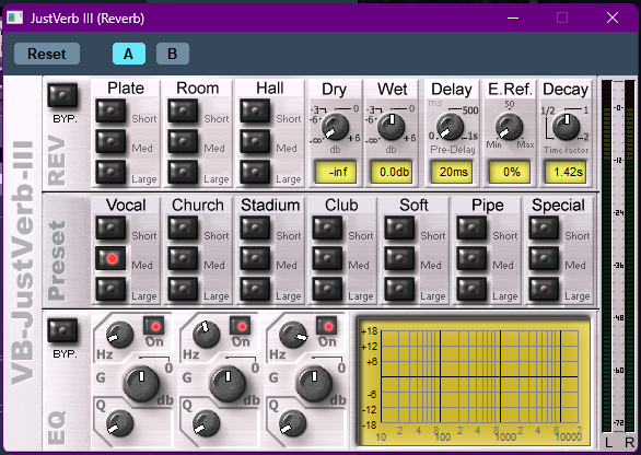

ok, this is something i cannot reproduce and the reverb is not expected to generate FP NaN or INF values.
could you post a screenshot of the Reverb GUI ?

Post by Paul17041993 »
its just at the default values currently, but nothing changes its behavior regardless, including bypass
