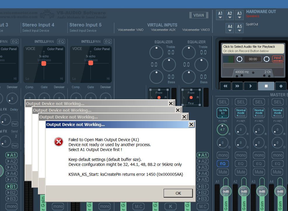

have you used Potato since a while without any problems. But then last week sound began to stutter. First thought it be an internet problem, but it wasn't. Playing a local MP3 file I got the same problem.
But without Potato I did not have the proble. So I thought I reinstall and update at the same time and ...
I took a snapshot and attached it. (PotatoSalad.jpg)
Below HARWARE OUT one can see in red Speakers it changes every 1-2 seconds to grey and then red again
Resetting and a system restart did not help. I also tried to set A1 to something elase and the nback to speakres ... nada, zero, nix !
Any ideas/suggestions ?

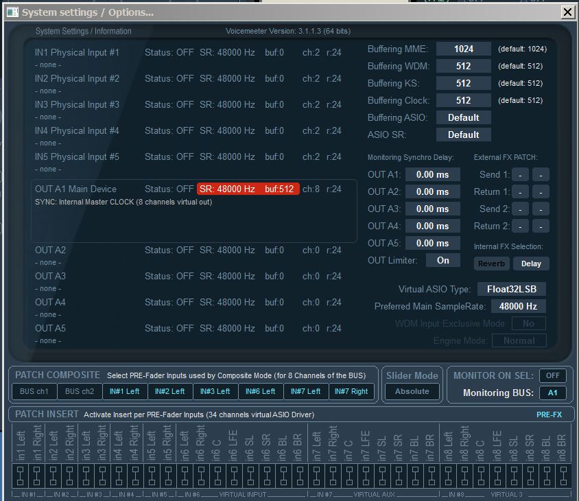

what is your voicemeeter version?
could you disable the "auto restart option" in menu ?
could you post a screenshot of Voicemeeter system settings dialog box?

Re: Potato first began to stutter, days later error me3ssages
Post by Joe »
Hi there,
Its Version 3.1.1.3 (64 bit)
I have switched off the Auto Restarts as you advised. So the message does not appear again and again without stopping. Thanks
in fact it means your selected device for output A1, did not start, you may deselect it to actually run on internal clock.
as explain in this topic; your may select a full functional hardware device as output A1, because it defines the main stream.
otherwise select nothing to keep the internal clock: viewtopic.php?t=451

Posts: 2202
I'm not sure you understood what i was saying.
your device selected as output A1 does not work (according your screenshot).
So or you select another one, or you select nothing to use the internal clock as main device.
