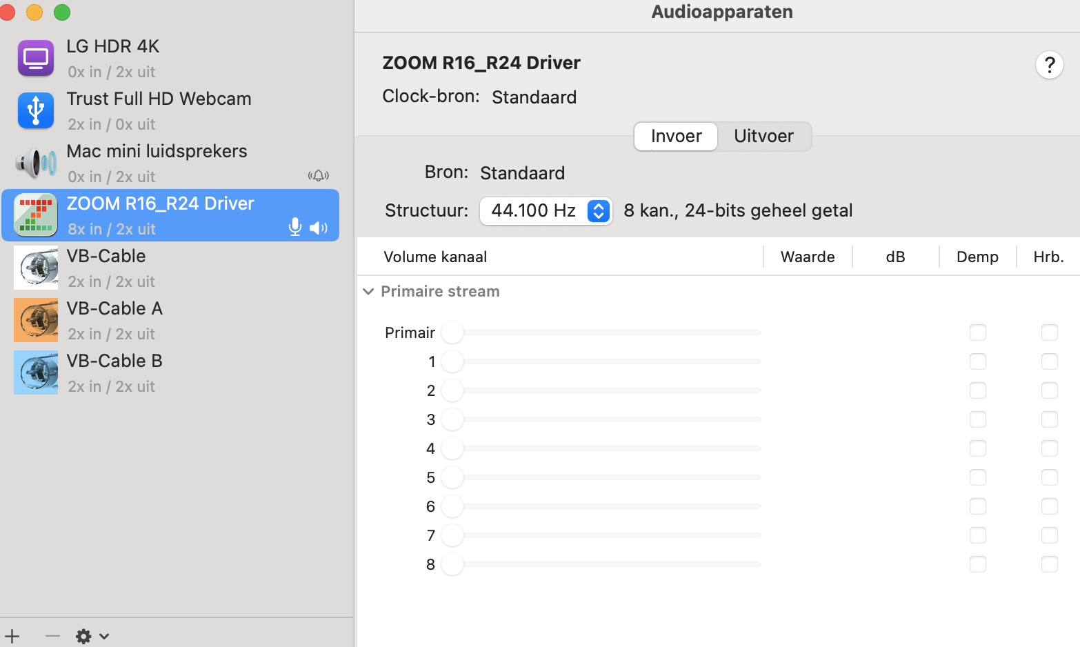

So I have the followoing audio devices on my max mini:

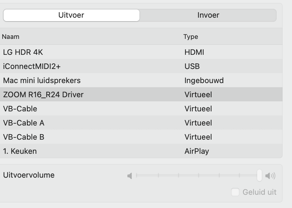

I am listening to a website via chrome. When i select Zoom R16 in the audio panel. the sound from this website is played over de Zoom R16 interface to my speakers.
Now i need to send it to an application. The application has a choice of audo sources. See the next picture.
How do i have to select, and what device where, to make it work and stream the audio to the application.
