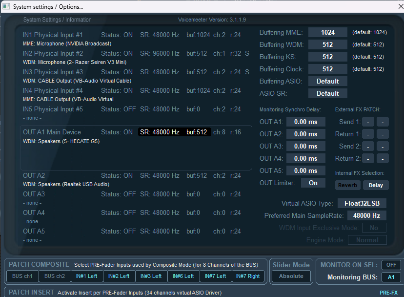

Hello so for some reason, voicemeter just messes up some of my games.
For F1 24 on Steam, every other second, the audio cuts off and return back to normal. I have no idea why this happens but when I shut down voicemeter and just connect the ingame audio to my headset directly, the audio plays normally without any disruptions.
For Adobe Premiere Pro, everytime I am previewing a video, the video stutters and the timemarker just jumps back 0.2s every so often making the video seem really slow. I have rendered the video fully and also used proxies but they still do not seem to work. I am also physically unable to record a voiceover due to the cut back of the time marker. Whern turning off voicemeter, everything works perfectly fine, I am able to record a voice over and the video plays without any disruptions.
Also every few minutes, voicemeter just gives up and thje audio becomes choppy and robot like and the only way to fix it is to restart voicemeter. Are there any possible solutions to these? I am using voicemeeter potato and am using to the fullest so I am unable to downgrade to a more simplified version. Attached are the setttings of my voicemeter.
Screenshot 2025-04-05 200658.png (123.25 KiB) Viewed 32649 times

First remark: you are not expected to use the same audio device on different points. As i can see on your screenshot, you have selected the VB-CABLE output on 2 different voicemeeter inputs with 2x different audio interfaces, this can be a problem.
