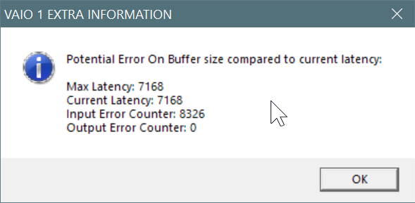

May I know what does this error mean?
2025-05-19_1109 VBCABLE_ControlPanel VAIO_1_EXTRA_INFORMATION.png (30.88 KiB) Viewed 75969 times
VBCable seems to be working fine. I don't hear any distortion or dropouts. Input 96000sps Output 44100sps.

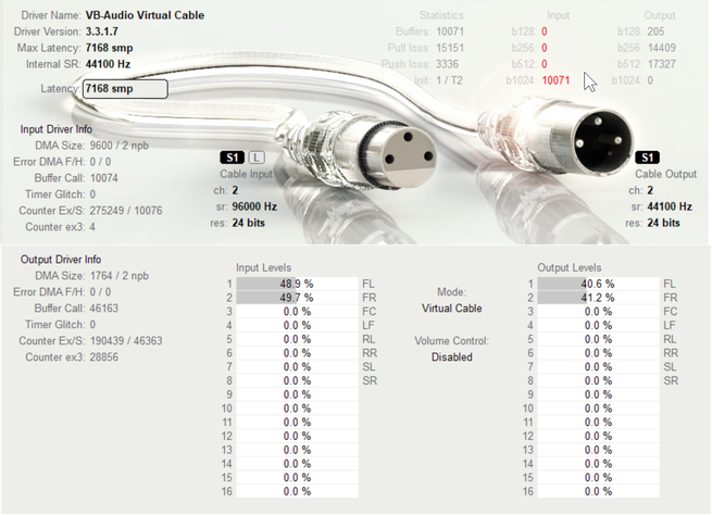

The main screen looks like this, all red in the input data statistics.
2025-05-19_1108 VBCABLE_ControlPanel VB-Audio_Virtual_Cable_Control_Panel_(Version_3.3.png
2025-05-19_1108 VBCABLE_ControlPanel VB-Audio_Virtual_Cable_Control_Panel_(Version_3.3.png (237.72 KiB) Viewed 75969 times
VBCable ver 3.3.1.7

Re: VBCable warning
According your current internal latency (7168 samples) the cable can consider counting error if the buffer size (used by connected app) is above 7168 / 3 = 2389 . You may check what buffer size is used by your player application (must be 2048 max usually).
This is potential source of problem, but can work in your case, because your internal samplerate is 44.1 instead of 96 kHz, so reduce the final number of sample by SRC, so finally can work correct.
