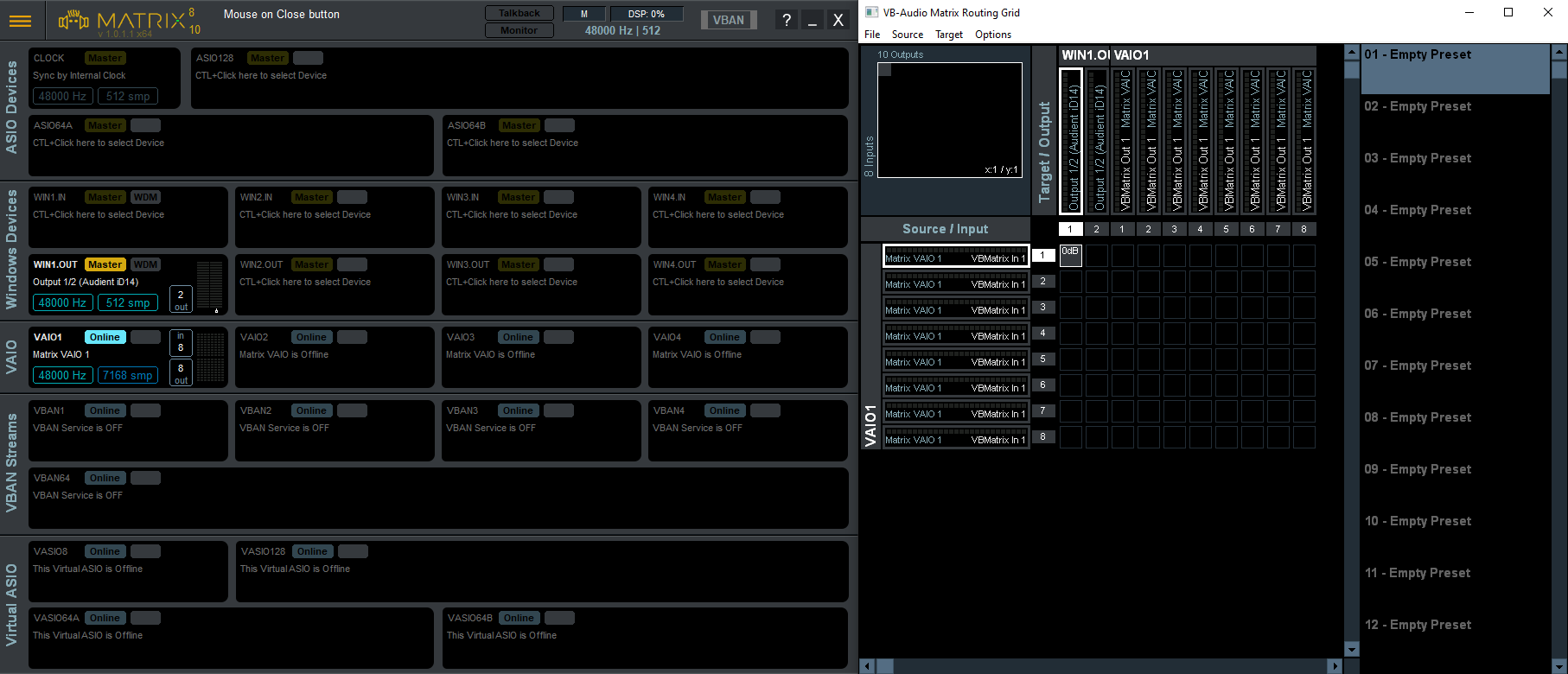

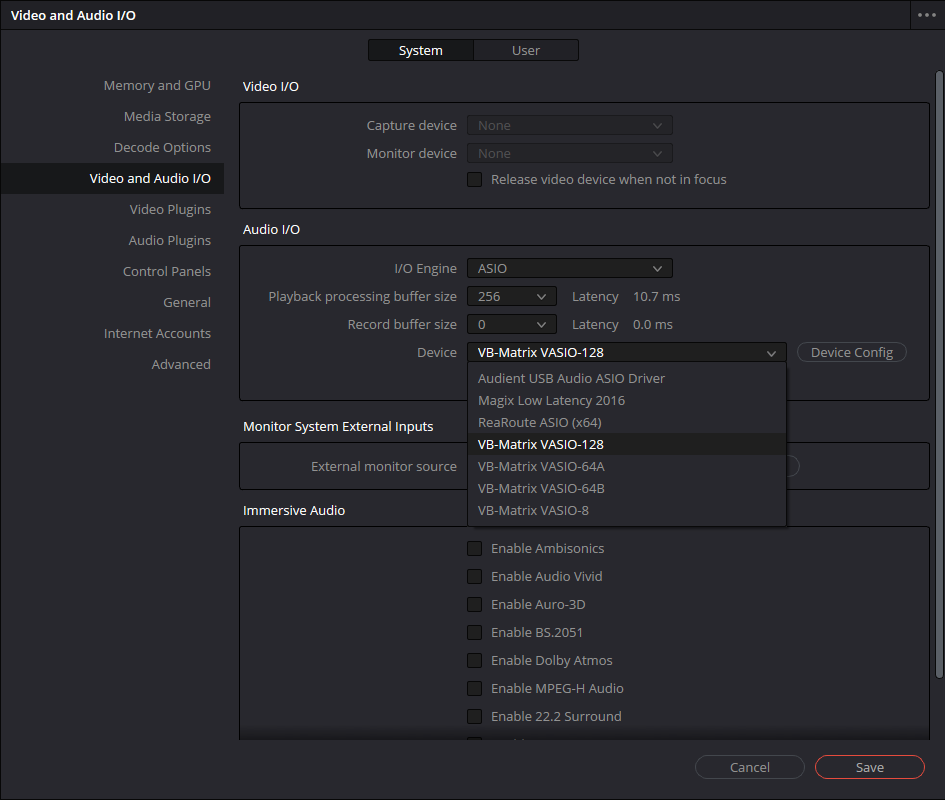

In Matrix, I created a virtual audio cable and routed it to my interface under Windows Device inside of Matrix. In Resolve I selected the virtual cable as my output. In Windows Sound the Audient 1/2 is selected as my default sound device. Here are screenshots of my full setup:
VB-Audio Matrix:
Matrix Setup.png (94.12 KiB) Viewed 288819 times
DaVinci Resolve:
Resolve Setup.png (73.87 KiB) Viewed 288819 times

Hi Vincent, thank you for your reply. I tried using the VAIO section in Matrix and I tried selecting all of the VASIO options provided in Resolve (128, 64A, 64B, and 8), but I cannot get any sound at all out of Resolve now. I’m still not sure what I need to do to get this to work.
Here are my new settings using the VAIO section.
Matrix:
Resolve:

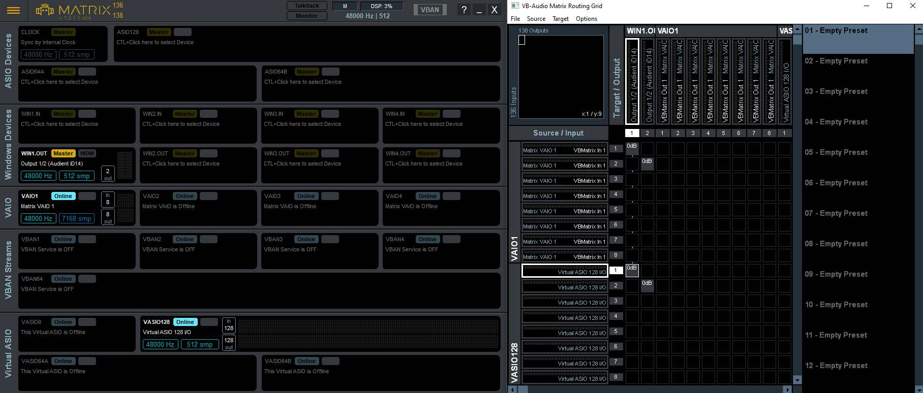

Re: Screensharing Problem with VB-Audio Matrix
if Resolve is connected to Matrix VASIO 128, you must set it online in matrix (the VASIO 128 slot).

Post by Tekkerue »
Thank you Vincent. I now get sound out of Resolve, but unfortunately I'm back to the original problem of it not working through Watch2Gether. I can screenshare without audio, but when I try to screenshare with audio I get an error that the device could not be activated. So it appears it is still not seeing it as coming from the Windows audio system.
I'm not sure if I need the VAIO setting, but I left it enabled. Here are my new settings from Matrix and Resolve is set to VB-Matrix VASIO-128:
Thanks again.
