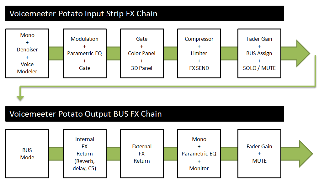

Hi!
In what order are the effects/filters in the hardware input strips (Potato 3.1.2.2) applied to the signal? Is there a schematic diagram or ordered list? I couldn't find it in the manual.
I'm particularly interested in whether I should set the noise gate or the compressor for a microphone signal first. But EQ, INTELLIPAN, Denoiser, special and external effects would also be interesting.
Thank you very much!

Re: Order of effects/filters in the Hardware Input Strips
yes, i've made a schema but maybe not published, don't rememenber, i'm going to note it for the user manual:

Thanks a lot, that really helps me!
