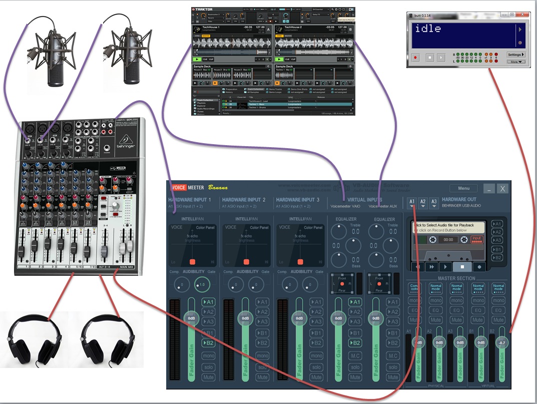

Thanks for the advice. I don't think the solution will work. But this is probably more due to the lack of knowledge on my side and not painting a clear enough picture of my setup. So let me first start explaining my setup. I included a picture of how the connections are running at the moment. And i will try to explain the connections.
I have two microphones connected to a mixer. These are for my and a co-host. The mixer has an USB connection on which audio goes out and also has an input. In Voicemeeter i selected the ASIO driver of the mixer for A1. This also sets strip1 to the 2(1 and 2) input channels of the mixer. The audio output on A1 gets send to the Mixer where it is send to the headsets. I make sure that this sound is not routed back to the mixers output. So there are no loops. For music i use Traktor. Traktor can only select one audio device. This means that audio device needs to have 4 output channels. (2 for main and 2 for monitoring). I use software called Butt to stream the mixer input (strip1) and Traktors Main output to a shoutcast server. Butt is picking op the audio from Voicemeeter AUX output.
At the moment i am using ASIO4ALL to group the inputs of both voicemeeter's virtual input strips into one virtual device. This makes it possible in Traktor to select that combined virtual device and select the first two channels of the voicemeeter VAIO input for Main and the first two channels of voicemeeter AUX input for monitoring.
The ideal situation would be to have Traktor come in on Voicemeeter VAIO with Main. And on Voicemeeter AUX with the monitor. That way it would be very easy to switch between sending the main or the monitor audio to the mixer/headsets by selecting A1 on the virtual strips.

- setupVoicemeeter.jpg (232.37 KiB) Viewed 29566 times

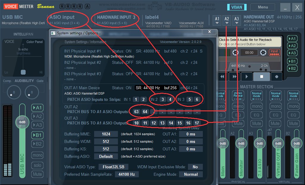

It has been a while. I am picking picking up broadcasting again and i saw that there are some new features with assigning asio channels to other input strips. Now i am having a little trouble wrapping my head around this patching, and maybe it does not support at all what i intend to do.
I am using DJ software (Mixxx at the moment). i want to route the output to voicemeeter. Now the problem is that i can only select one asio device for main output and monitoring. So if i select Voicemeeter virtual asio I can select channel 1 and 2 for main and 3 and 4 for monitoring. But this will result in both main and monitoring comming into voicemeeter on the first virtual strip.
Would it be possible to "patch" channel 1 and 2 to one strip and channel 3 and 4 to another?

With last VOICEMEETER, there is ASIO Routing capabilities for BUS A2 & A3 that can also be routed to output channels of the ASIO device selected for output A1. More information in user manual page 18: http://vb-audio.pagesperso-orange.fr/Vo ... anual.pdf
