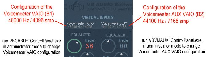

Anyway, to go back to your specific problem, the cause could be more in the Voicemeeter VAIO or VB-CABLE internal parameters... internal latency could be increased to prevent such problem on virtual connection between Chrome and Voicemeeter virtua l I/O or VB-CABLE...
If you have some problem on Virtual connection, you can check the related VB-CABLE configuration, set to 44100 Hz / 7168 smp

I changes the control panel to set the AUX I/O to 48 KHz. At that point Chrome last all access to audio. Closing and re-launching it again I was able to rejoin the Hangout with audio.
The fault did not occur again, even though the broadcast ran for another 75 minutes.
ok, Well, so the problem is more in the internal buffer size than internal samplerate (because our VAIO include SRC), the fact is that you get the biggest internal size with this settings: 44100 Hz/ 7168 smp. If you want to understand everything in this domain you can read this note: http://vb-audio.pagesperso-orange.fr/Ca ... ttings.pdf
...But to explain quickly, our Virtual Audio cable or I/O are configured per default to work with a buffering around or below 1024 samples . If an application uses 2048 sample buffer at 44100 Hz (which can be the case with some video game using DX or web application programmed by biologist) it could not work for some of our default settings like 44100 Hz / 4096 smp, or 96 kHz / 7168 smp...
so if setting the VAIO to 44100 Hz / 7168 solved the problem , it means that chromes was using too much big buffer for the current VAIO settings.
Have there been any other reports of problems with VMB interacting with Chrome when 44.1 KHz sampling is used for the AUX I/O?
yes sometimes we got such report, especially when users are decreasing internal buffer of the VAIO or VB-CABLE to try to improve latency, but they often get no sound anymore at the end... reseting to 44100 / 7168 or 4096 solve the problem. But we have some rare case where even 44100 / 7168 settings is not enough, already got the problem with Micosost Lync some time ago...
