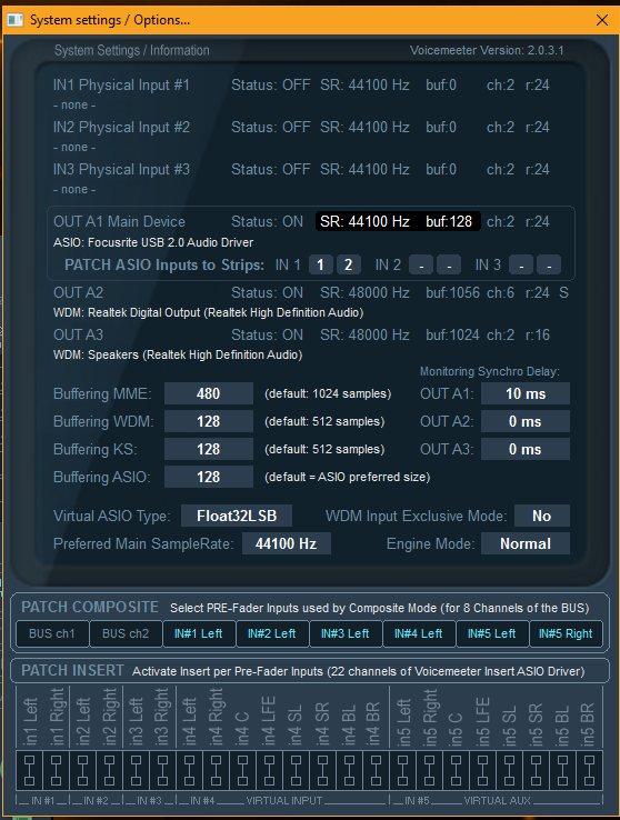

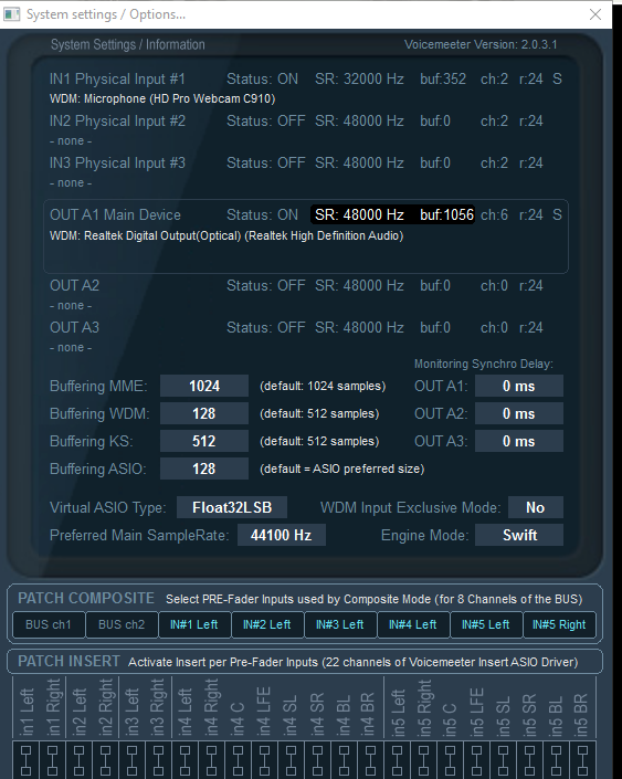

I have attached screenshots of my settings, I hope this helps. In the screenshot, it shows internal SR 44k1, but I have tried with 48k also and the behaviour is the same.

1- you may set the Engine Mode in NORMAL (swift remain experimental and does not work well with shared audio device).
2- your Realtek Digital output is used in SHARED mode (S) that's why buffer is given by the device itseld and not the preferred one
if configured in 5.1 DTS i'm not sure this device can work in exclusvie mode in fact...
what i recommend is to connect output A1 to a regular audio device that can work in exclusive mode with right buffer size (512 sample for WDM)... and connect your Optical device on output A2 (with WDM or MME)...
output A1 in Voicemeeter is giving the main master audio stream and must be connected to your best, most reliable, most stable audio output device...

This screenshot is one of many configurations which I attempted, but the same behaviour is seen in normal mode and swift mode.
I tried to use my only other sound card, which is the HDMI audio to my TV, as A1, then, my optical output as A2.
Behaviour is the same as above - distortion throguh the WDM interface, MME has no distortion but high latency.
I have confirmed that no other apps are using the sound card. Not sure why it is in shared mode.
