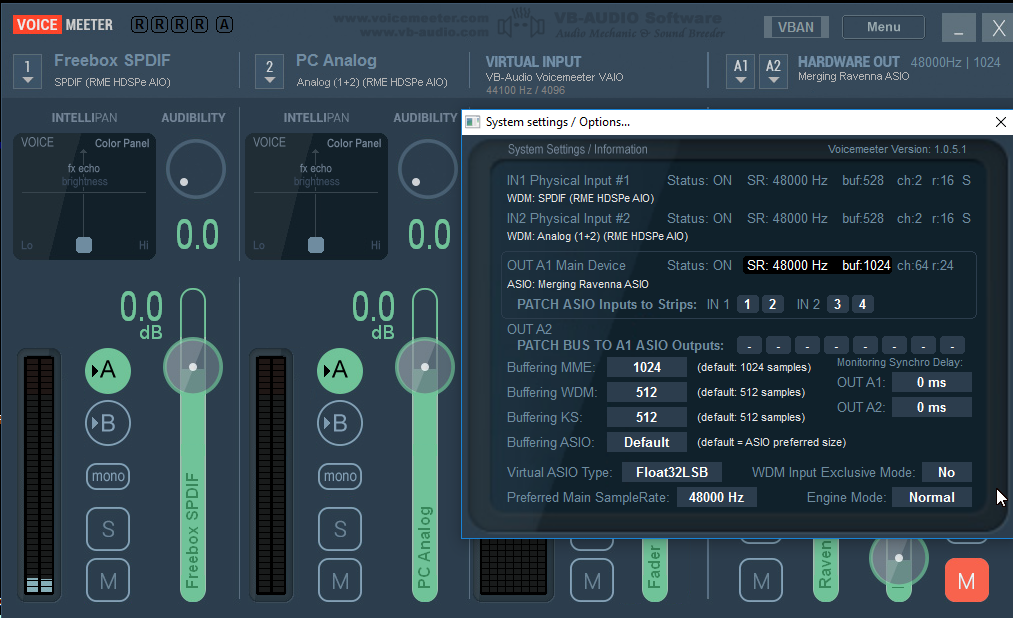

I have Voicemeeter 10.0.5.1 installed on Windows 10 x64.
It works fine at 44100 and 48000, but crashes as soon as 88200 or 96000 is selected (Preferred Main Sample Rate).
The ASIO driver is of course compatible with both. The same configuration used to be working fine on Win 7 64, so I'm quite surprised.
Is there any way to find out what is happening?
Thank you

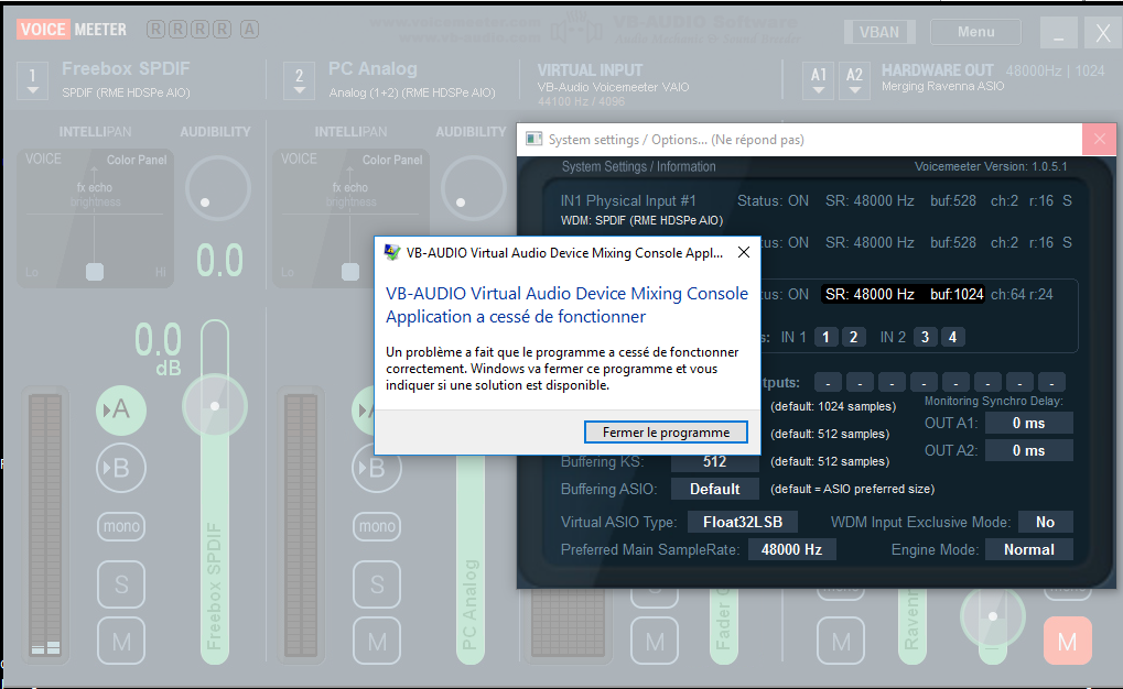

I got this in the event log:

Working configuration and crash look like this. Crash is just after Windows pretends to look for a solution for a few second, and right after 9600 or 88200 has been selected as Preferred Main SampleRate (exact sequence of events : select rate, sound stops right away, , VM hangs for a few seconds, and then Windows gives the bad news):Nom de l’application défaillante voicemeeter.exe, version : 1.0.5.1, horodatage : 0x57f65ce7
Nom du module défaillant : voicemeeter.exe, version : 1.0.5.1, horodatage : 0x57f65ce7
Code d’exception : 0xc0000005
Décalage d’erreur : 0x00027505
ID du processus défaillant : 0x1ad4
Heure de début de l’application défaillante : 0x01d25c7b5cf4f874
Chemin d’accès de l’application défaillante : C:\Program Files (x86)\VB\Voicemeeter\voicemeeter.exe
Chemin d’accès du module défaillant: C:\Program Files (x86)\VB\Voicemeeter\voicemeeter.exe
ID de rapport : 69b76ce8-4040-422d-a09a-7a0bed3a31b9
Nom complet du package défaillant :
ID de l’application relative au package défaillant :
- okWin10_48000.png (169.25 KiB) Viewed 15888 times
- CrashWin109600.png (155.95 KiB) Viewed 15888 times
