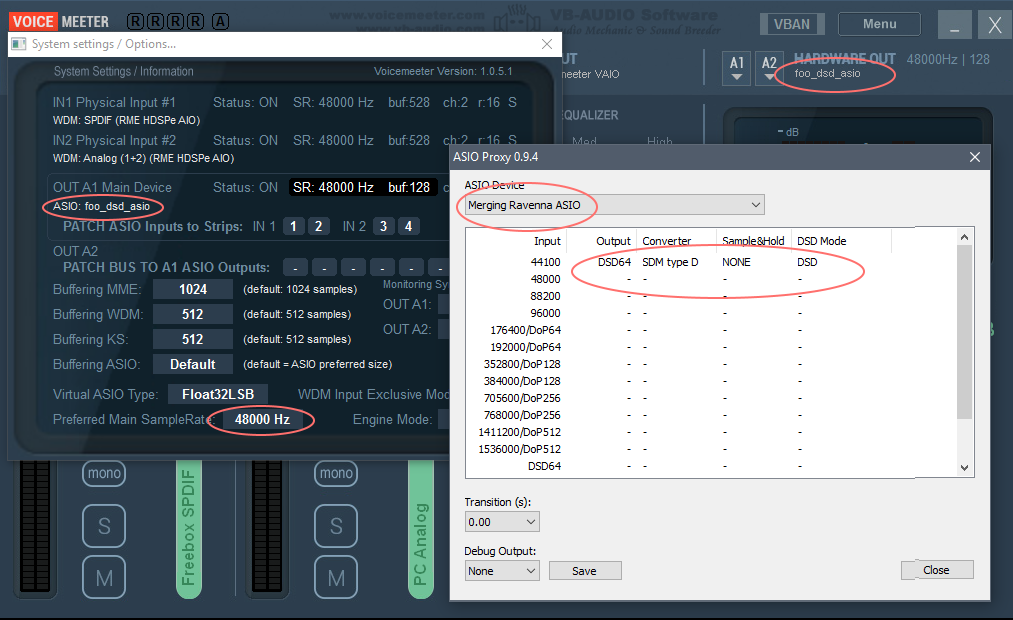

This brings up the attached ASIO Proxy 0.9.4 configuration table. In this picture, foo_dsd_asio is configured :
- to output to ASIO Device : "Merging Ravenna ASIO"
- to convert 44.1k input to DSD(64), and leave all other input formats unchanged. It gets configured like that by clicking the various table cells, which brings popup menus from where to choose the various configuration options (i.e. here: DSD64, SDM type D, NONE, DSD).
Once you have this configured, check that VM (configured at 48000 Preferred Main Samplerate) works fine. It outputs to foo_dsd_asio, which in turn outputs to Merging Ravenna ASIO, without doing anything else.
Then, change VM Preferred Main Samplerate to 41000, and then VM unexpectedly shuts down.
Another way of getting the same problem, is to go back to foo_dsd_asio configuration table and change the 48000 line to have the same parameters as the 41000 line configured earlier (w/ VM at 48000).
Bottom line, it's fine to get foo_dsd_asio to pass stuff from VM to foo_dsd_asio output driver, but as soon as foo_dsd_asio configuration requires, in addition, a conversion to DSD, VM crashes.
You can check under another asio host (such as foobar or Jriver, ... should work on any host) that foo_dsd_asio can be selected as its output, and that everything still works when foo_dsd_asio does actual PCM to DSD conversion.
I have only tested this with Merging Ravenna ASIO as it's the only DSD capable thing I have. It could be that the Merging driver plays a role here ( like there http://vbaudio.jcedeveloppement.com/for ... ?f=6&t=426 by the way, David from Merging said he would discuss it next time he talks to you )
- foo_dsd_asio.png (130.01 KiB) Viewed 9074 times
