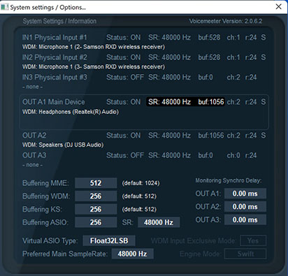

So I turned SWIFT MODE and INPUT EXCLUSIVE back on, no change.
Tried high end wired USB mic and XLR mic with USB interface, no significant change.
Reinstalled latest Realtek driver, no significant change.
Went through Windows 11 settings, made sure all set to 16 bit, 48kHz. Turned off Exclusive Mode and Signal Enhancements for all sound devices (some did have one or both of these turned on). This improved the latency somewhat but it is still noticeable.
Checked system settings and now A1 shows 1056 buffers although the setting is 256. Also IN1 buffers have jumped to 528. What is going on?

you buffer size is too high.
you may find a way to have a buffering around 256 samples on output A1 (giving the main stream).
