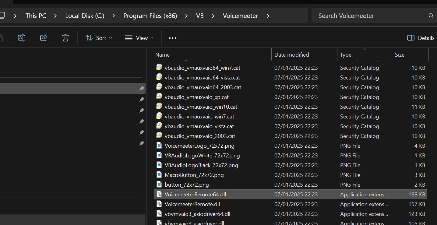

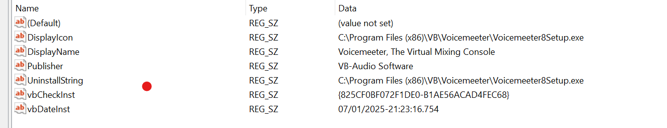

Thanks, I checked. Yes, I'm pointing to the correct dll. I think.
The location
The location
VBVMR unintall.png (31.7 KiB) Viewed 385933 times
The DLL
The DLL
I did a complete reinstall to make sure I had just one such DLL. This one has the version I noted, and yields 0 as result regardless of the button state. Also, I can't control buttons anymore.

Edit: I added some code to use the registry entry, and this gives the same result (does not work).
Suggestions are welcome.

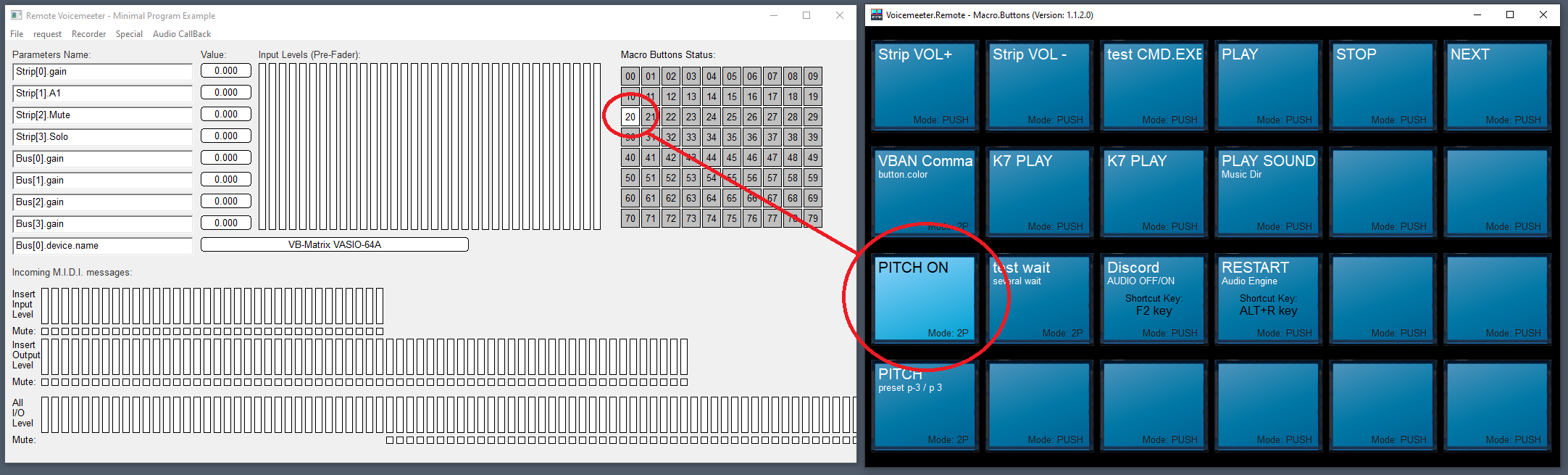

Ah yes... more insights.
Thanks for the great help, your tool was a great idea, it showed me I did read the proper value - then I found this:
It's just like the commands under "Request For Initial State" do not run anymore at Macro Button startup. Or, too early and get overwritten after.
If I put this in:
Request For Initial State.png (2.99 KiB) Viewed 385904 times
This does not get done. State and color are unchanged*. This did work in an earlier version. When this isn't done, my script which depends on this, can't do what I want and appears to fail. But the reason is not the script nor the API, it's that request initial state that seems to not work, or at least, has unexpected behaviour.
Again your ideas are highly appreciated.
* = This version of Macro Buttons does partially remember button states, which the earlier versions did not do. Colors are not remembered until the mark to "Store Last Button State" is checked. Major differences, in my opinion..... breaking functionality.
