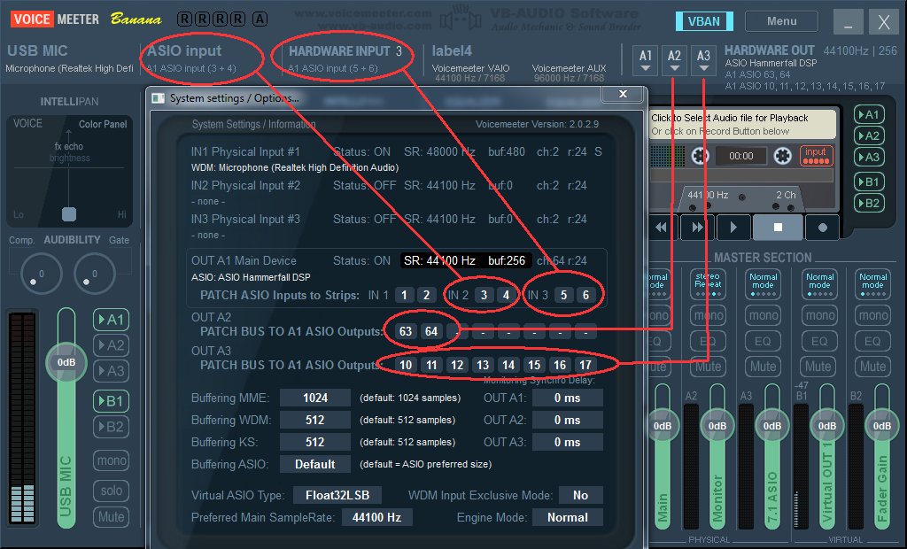

ok, i see a possible audio conflict
you use your ASIO device as output A1 (with 512 sample buffer) = good!
but you also selected MG-XU Line in as harsdware input #1 : this is a conflict, because you ask for WDM access to an audio driver already accessed with ASIO interface.
to use your ASIO device input directly in Voicemeeter :
you may select nothing as hardware input...
and possibly use ASIO patch to route ASIO input in Voicemeeter strip

Well i have a Mixer Yamaha mg10xu and my Microphone is in the Mixer Same as my Headphones, if i dont select any input device as microphone i cant use it in Voicemeeter right ?

if you have selected your Yamaha mg10xu ASIO driver as output A1
you normally should not have to select it as WDM device for your microphone...
because the ASIO PATCH can do it for you directly in a better way.

ok so i have those settings set now, and in Windows Sound settings in looks like this
https://imgur.com/a/OgQkeIx <--------- Playback Device
https://imgur.com/a/PZ8DZaS <--------- Recording Device
https://imgur.com/a/gFnUeZ8 <--------- Voicemeeter Settings
This is how i set it up, is this correct ?
thank you for your help !
