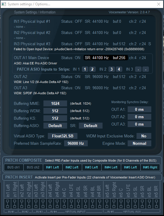

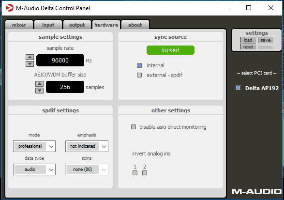

well, we have M-Audio Delta, used for our Voicemeeter test, we never got problem.
please , let me know your exact configuration for the M-Audio Board (screenshot if possible)
and send a screenshot of Voicemeeter System settings Dialog box.
we will try to reproduce yoru problem.

Here's the configuration.
Config Delta.png (21.16 KiB) Viewed 24200 times
Config Voicemeeter.png (77.86 KiB) Viewed 24200 times

you may set the M-Audio ASIO buffer size to 512 sample instead of 256
if you use more I/O of your M-Audio device, it could be better to use it as output A1...

Now will I be able to keep the EIE pro as ASIO if I put the Delta as A1?
That's the only way I know of to be able to use all four inputs of the EIE pro.
EDIT:
Tried that and it didn't work.
Tried setting the Delta 192 as A1 and I couldn't set the EIE on A2 as ASIO.

V-IN-2 Voicemeeter AUX is showing no driver present.
I saw where the VB Audio virtual cable was no longer installed so I installed it.
Seems to have made the V-IN-2 work although it still shows no driver present.

Hello!
I was with the same problem and I turned what's inside of red circle to YES and solved my problem.
Cya, thank you.
