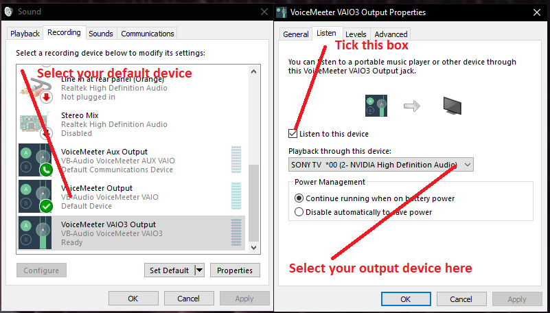

Moving on up the chain from there, if it were an issue with the virtual device somehow, you could cut voicemeeter out of the situation here. If you close VM, then the virtual cable will send its input to its output, and then you can use windows to redirect that to the USB sound device. Here's a screenshot of how that looks on my PC, I've used VAIO3 but you should just use the normal default, and I've set the output to my TV but you should select your USB device:
Again, leave the config screen open (to check for push loss) and task manager running (to check for overload), but this will give you a chance to see if the virtual device is glitching out without VM being in the loop.
