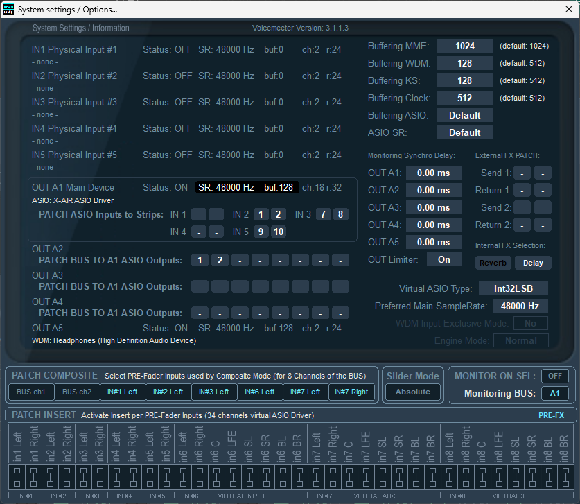

assuming you are using latest Voicemeeter version. You may check your output A1 device (or select another one or select another audio interface ASIO, WDM, MME...) to find a more stable audio config i guess...
for more help, you may post screenshot of your voicemeeter system settings dialog box.

by stoepie
Thanks for the help.
I use a Behringer XR18 air, ASIO driver, default settings.
Voicemeeter system settings.png (118 KiB) Viewed 114510 times
All audio works flawlessly, only VBAN stutters sometimes.
But I've found a post regarding power save settings on the ethernet card, and disabled it, as did the folks I talk with. Haven't had issues since (1 day so it may be too short to tell).
-David
