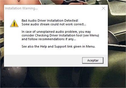

this message is appearing to me every time and I do not see anything wrong, the windows is updated and reinstalled the audio drivers
- 1122.jpg (33.67 KiB) Viewed 311486 times

- Posts: 2211
Re: Voicemeeter or Audio problem after WIN10 update
you may re-install it correctly,
follow recommendation given in 2 fisrt message of this topic:
https://forum.vb-audio.com/viewtopic.php?f=7&t=688

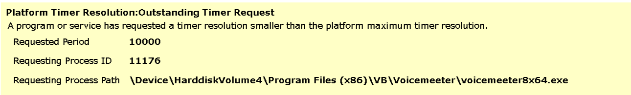

Latest windows 10 update seems to be ignoring timer requests from Voicemeeter potato and other software . Anyone else seeing this ?
- FireShot Capture 145 - - .png (7.26 KiB) Viewed 310955 times

Are you sure the requests are ignored? Try this tool to see what timer resolution you're actually using: https://github.com/tebjan/TimerTool (download page linked in the top right)Tony EI7BMB wrote: ↑Tue May 04, 2021 5:40 pm Latest windows 10 update seems to be ignoring timer requests from Voicemeeter potato and other software . Anyone else seeing this ?
It's normal for a timer request to be 'outstanding' - Imagine this scenario:
App 1 requests 1ms timer
App 2 requests 1ms timer
App 1 exits
What will occur is:
Step 1 will result in decreasing the timer period per App 1's request.
Step 2 will result in the timer not being altered as it is already in the desired state. The request is kept.
Step 3 will result in App 1's timer request being removed, thus allowing the timer to return to default state...
However, the request from App 2 is still outstanding, and now it takes effect.
Accordingly, no change is made to the timer.
Without this 'outstanding' request to change the timer config, step 3 would result in App 1's request being cleared, and the timer returning to normal, leaving App 2 with the wrong timer config.

Thanks for the explanation about "outstanding requests" most kind . I have reverted to Windows 1909 and now the request from the app is being processed as before . It seems this is a real issue for some though though https://randomascii.wordpress.com/2020/ ... le-change/

Huh interesting, I wasn't aware of the change. Anyway the change means that the scenario I described won't be an issue any more because apps timer requests don't impact each other...
And we can see that the requests from VM to modify the timer period are there, and with the tool I linked we can see that they are working (also, I can only assume VM wouldn't work if they weren't)...There is one issue effecting us here, which is that powercfg reports the current timer resolution as the maximum.... which actually makes some sense because each app will have its own timer interval now. But also makes no sense because it suggests the slower timer that isn't in use for many apps...
Another user noticed this and mentioned it in the comments
Anyway, fortunately because VM is well implemented and requests the 1ms timer anyway, the change doesn't effect VM, other than misleading powercfg reports, so we can safely stay on 2004+

Thanks again for your help and futher explanation. I was able to go back to Windows 10 20H2 with a modification to the registry to fix another program and Voicemeeter working fine . Phew
