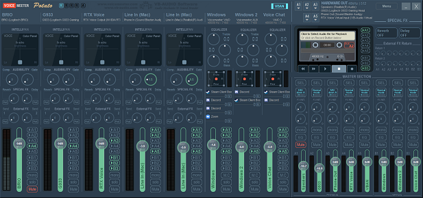

In my case the config xml is stored in my documents but that is both on my d drive and setup to use OneDrive so full path is
D:\OneDrive\Documents\Voicemeeter configs\Voicemeeter.xml
I have tried changing Voicemeeter configs to Voicemeeter and that did not help. I tried putting it on my desktop that is on my C drive and not using OneDrive and that did not help. I have also tried creating a 'fake' documents folder so that %userprofile%\Documents would resolve but that did not work either.
In my case it is also happening on both reboot and Voicemeeter restart. It is also only a few things that are not remembered. Most of the settings are saved properly. oddly it changes toggle states but remembers the volumes.
This is my config before closing Voicemeeter or rebooting:
2020-05-08 16.09.51.png (204.32 KiB) Viewed 45423 times
And this is what it is when Voicemeeter starts up again:
2020-05-08 16.10.13.png (204.68 KiB) Viewed 45423 times

Are you using Voicemeeter buttons or MIDI to set some things?

Kilrah wrote:Are you using Voicemeeter buttons or MIDI to set some things?
Good call. If you have voicemeeter starting the macrobuttons app, and the initial state in the macrobuttons is wrong, that'll do it.
You nailed it. I had some unused MacroButtons that had initial stats set but that I haven't used in ages so forgot about. Deleting them fixed the problem instantly. Thanks for pointing that out. I have not had problems with that before, so I didn't think to check it, but my last change rearranged my strips (or busses I always forget, the inputs anyway) so all the numbers in the MacroButtons were wrong.
