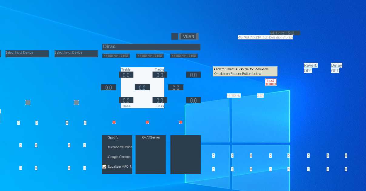

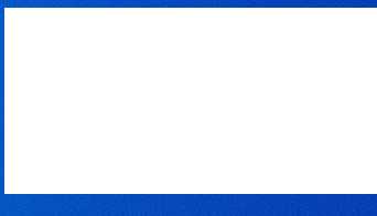

Ok, back with screenshots as well as thread stacks from Process Explorer.
Tray menu when UI is stuck
Main UI when stuck
Main UI when stuck
Yes, it is "transparent". Buttons seems to response if I can guess where they are, at least on the Tray menu not sure about main UI.

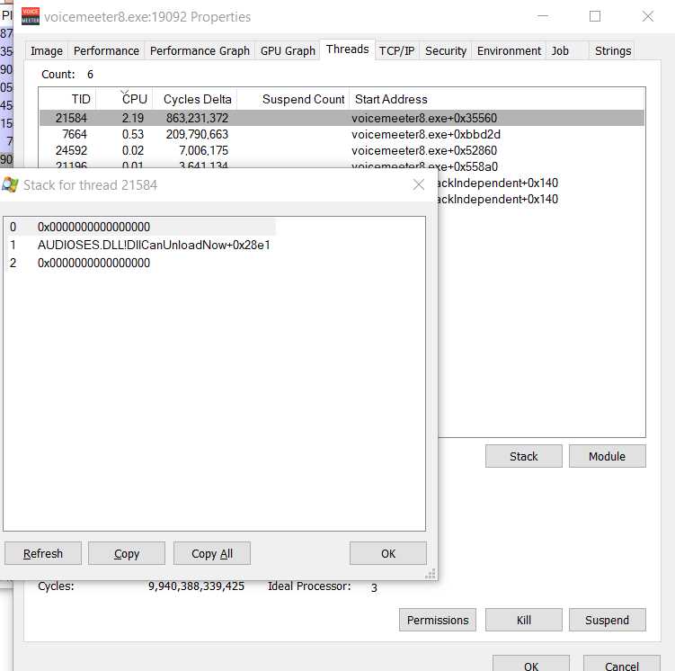

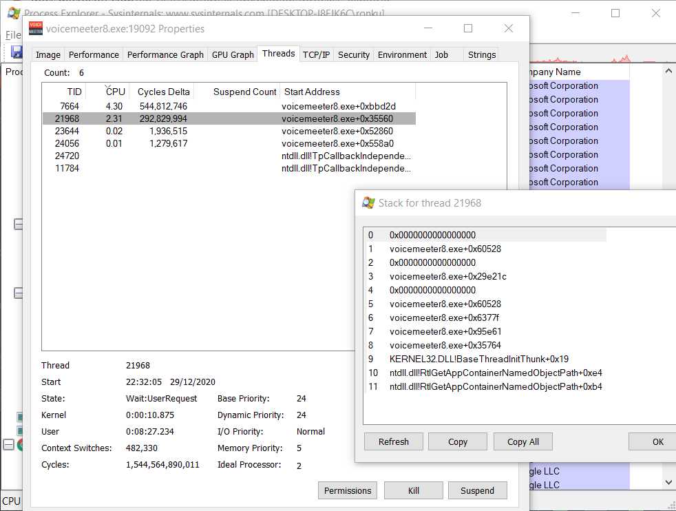

Posting stuck vs. normal state thread stack from Process Explorer which might help (limited to 3 attachments per post):
Stuck thread 1/5:
Stuck state
Stuck state

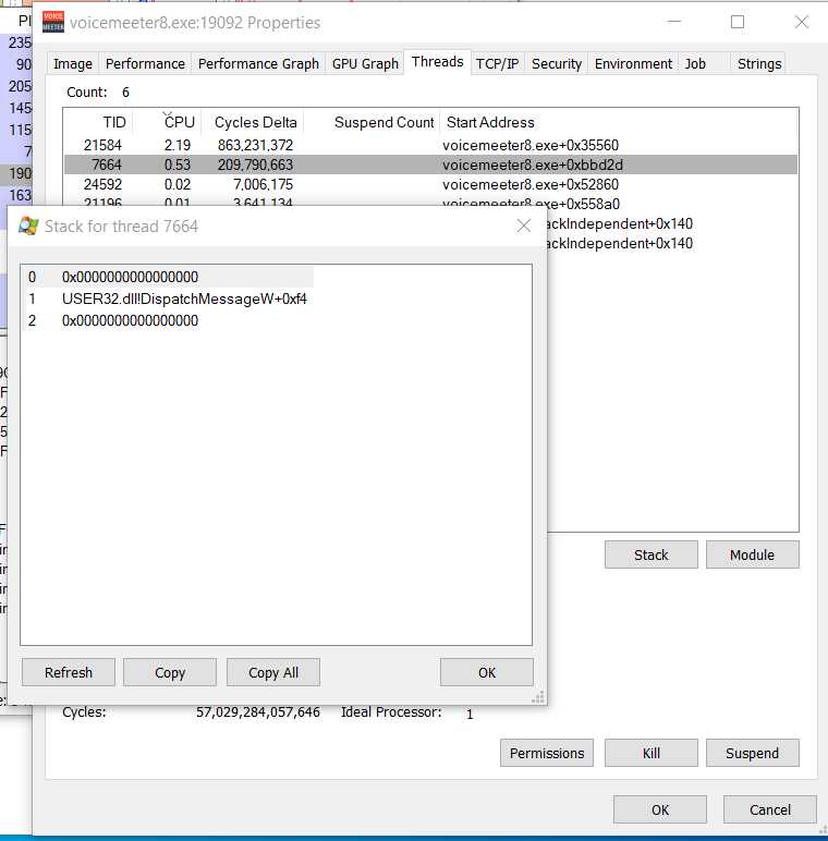

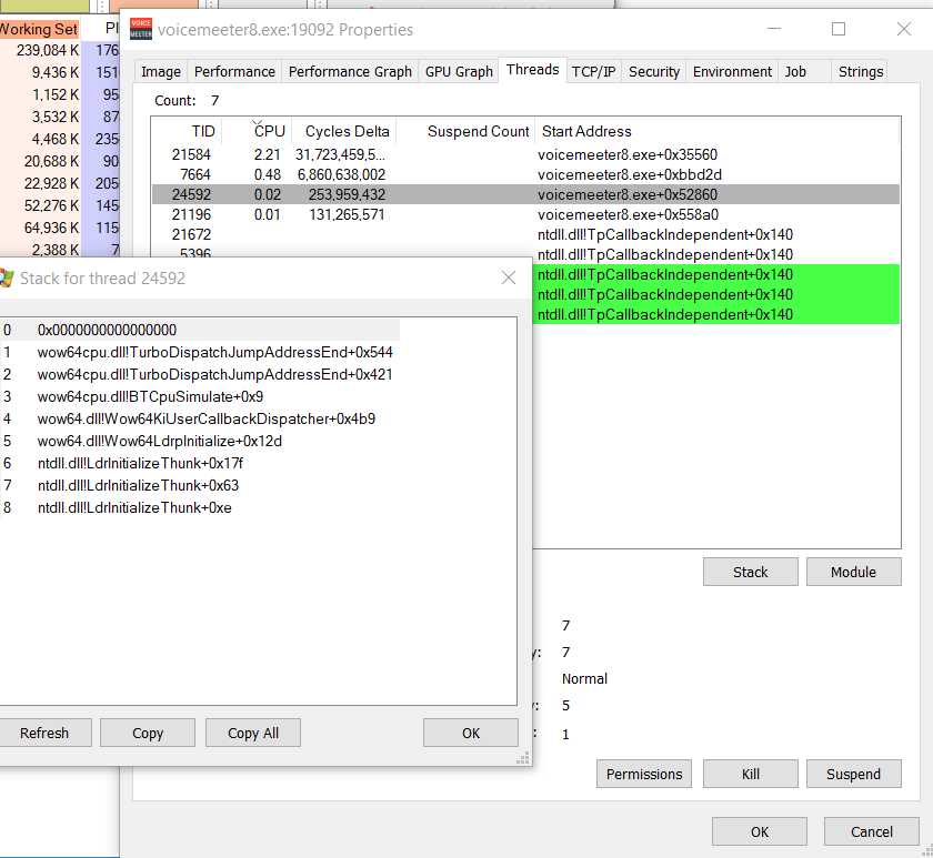

Normal thread 1/5:
Normal state
Normal state

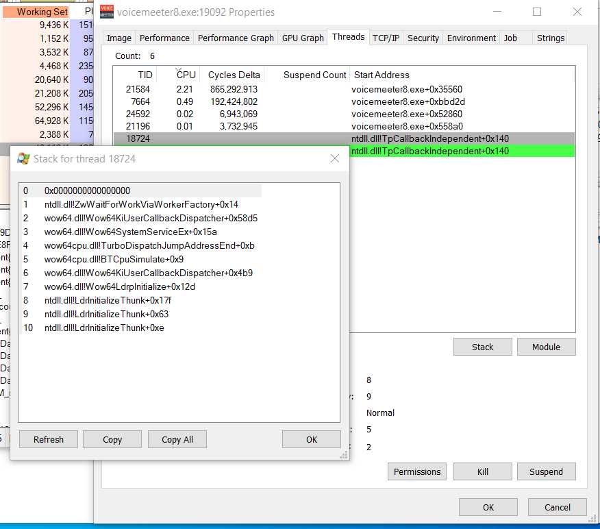

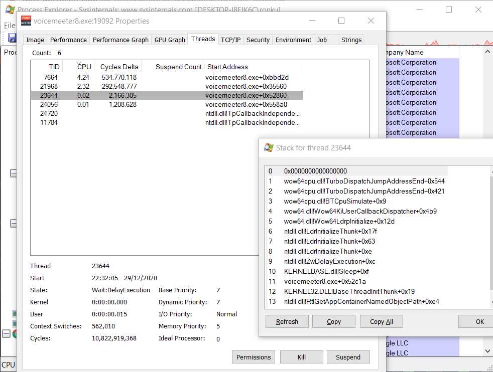

Stuck thread 2/5:

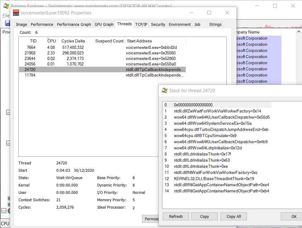

Normal thread 2/5:

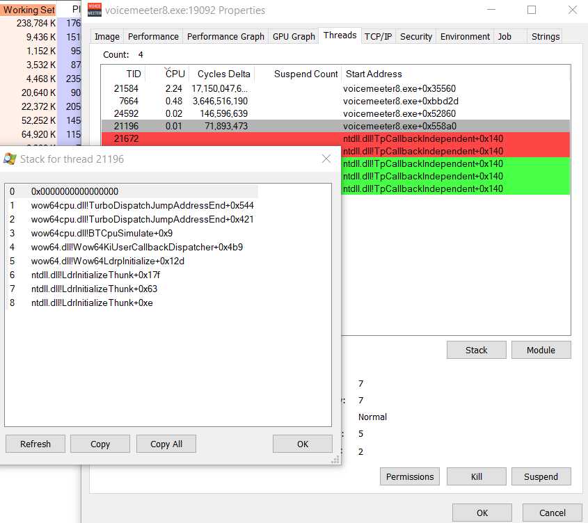

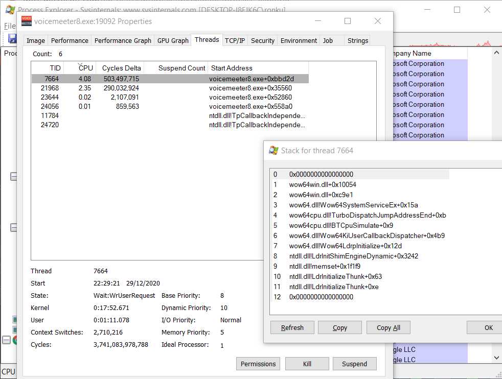

Stuck thread 3/5:
Normal thread 3/5:

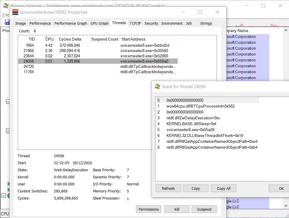

Stuck thread 4/5:
Normal thread 4/5:
Re: Potato UI freezes/unresponsive after extended sleep
Posted: Fri Jan 01, 2021 2:56 pm
by ronkuper
Stuck thread 5/5:
Normal thread 5/5:

As observable from the screenshots besides the stack difference, the stuck state also has a ntdll.dll threads spawning (green) and terminating (red) continually which is not present in normal state.
Hope this could help troubleshooting this very annoying bug.
If I can help by collecting more data points during stuck state please let me know which.
