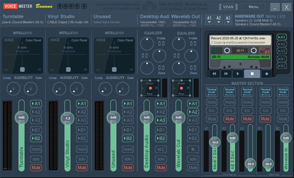

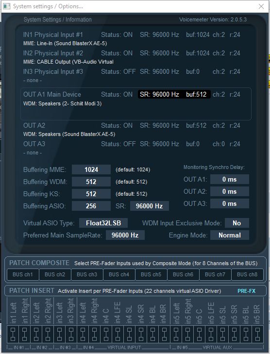

I have Banana working well with my recording software (Wavelab Essentials 10) using Voicemeeter Asio inputs/outputs. However my turntable input is suffering from 10ms silence being inserted into the input every 10-12 minutes. This happens when I listen to the input on Banana and is also recorded in Wavelab. I have tried WDM and MME at all buffer sizes.
If I go back to my previous setup using the Soundblaster AE5 Asio inputs/outputs into Wavelab it works perfectly.
I have attached screenshots.
This is driving me crazy! Any ideas?
Banana System Setting.jpg (88.27 KiB) Viewed 13919 times

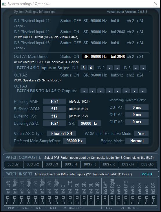

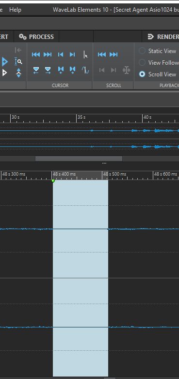

I am now using AE5 Asio for A1 Output and have patched Asio Inputs (3/4) to In 1.
Sound is fine but now the inserted silences are up to 109 ms and are more frequent. I have increased the latency on the AE5 Asio control panel with no effect.
I have adjusted the Buffering Asio setting to 1024 also with no effect. As you can imagine this is unusable.
VB Main Screen.jpg (123.83 KiB) Viewed 13902 times
System Settings 05-26.jpg (89.92 KiB) Viewed 13902 times
Wavelab silence 109ms.jpg (41.21 KiB) Viewed 13902 times
