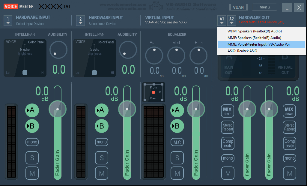

Hi. After applying Windows 10, version 2004, VoiceMeeter Input appears as a MME device in the hardware output selection list. VoiceMeeter Output also appears in the hardware input selection list.
I have no problem using Voicemeeter but this is strange.
VoiceMeeter Input listed as hardware output device

- Posts: 192
Re: VoiceMeeter Input listed as hardware output device
Hi. Thanks for your help. I followed the uninstall + restart procedure and after re-installing Voicemeeter I got the same result. I did a fresh install of Windows 10, version 2004 to see if this behavior could be related to the update process; in the newly installed system Voicemeeter also list the VAIO devices in the hardware input and output selection list.
Is there anything I can do to help with debugging this behavior? I will try to reproduce it in my laptop.
Update: After a fresh install of Windows 10, version 2004 (using the same media) on the laptop, Voicemeeter exhibits the same behavior.
