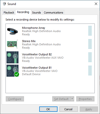

Re: Audio Noob
Hi. It is normal to be confused by audio mixers routing in general.
You selected the correct output. VoiceMeeter Aux Output is connected to the B2 bus and VoiceMeeter VAIO3 Output is connected to bus B3.
Windows allows to change the name of playback and recording devices so if you prefer you could change to something like VoiceMeeter Output B1. See for example this screenshot (using Voicemeeter Banana):
Sound Control Panel Device Name.png (21.9 KiB) Viewed 11422 times
