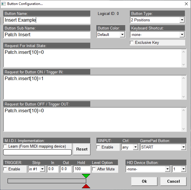

Hi. You can configure a 2-positions button in Macro Buttons to turn on/off patch insert for a channel. The parameter is Patch.insert[k] where k goes from 0 to 21. (There are 22 channels in total). See this example:
Insert Example.png (24.27 KiB) Viewed 9447 times

Andres wrote:Hi. You can configure a 2-positions button in Macro Buttons to turn on/off patch insert for a channel. The parameter is Patch.insert[k] where k goes from 0 to 21. (There are 22 channels in total). See this example:
Thanks! That worked :)
