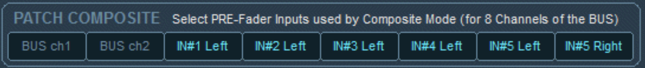

  • Select System Settings / Options... from the Menu. Locate the PATCH COMPOSITE:
    patch composite.PNG (142.31 KiB) Viewed 22450 times
    Click over the text that reads Select PRE-Fader. It should change to POST-Fader
  • Select IN#1 left in the first box (leftmost). Select IN#1 Right in the next one (These are the 2 channels from your first microphone). Select IN#2 Left in the third and IN#2 Right in the fourth (These are the 2 channels from your second microphone)

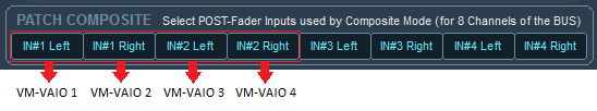

So, that got me most of the way there. One of the mics is now working as intended, but the other is still going to both tracks and I don't know why.
I've grabbed a screen shot of all the things I think might be relevant to try and make this easier.
https://imgur.com/b33Cily
Re: Two Mics, Two tracks
Posted: Mon Sep 28, 2020 5:56 pm
Hi. Please use the following PATCH COMPOSITE settings:
patch composite.png (6.83 KiB) Viewed 22420 times
Channels 1 and 2 are connected to Hardware Input 1 (Left and Right)
Channels 3 and 4 are connected to Hardware Input 2 (Left and Right)

THANK YOU!!!!
that made it work. You're an absolute legend.
