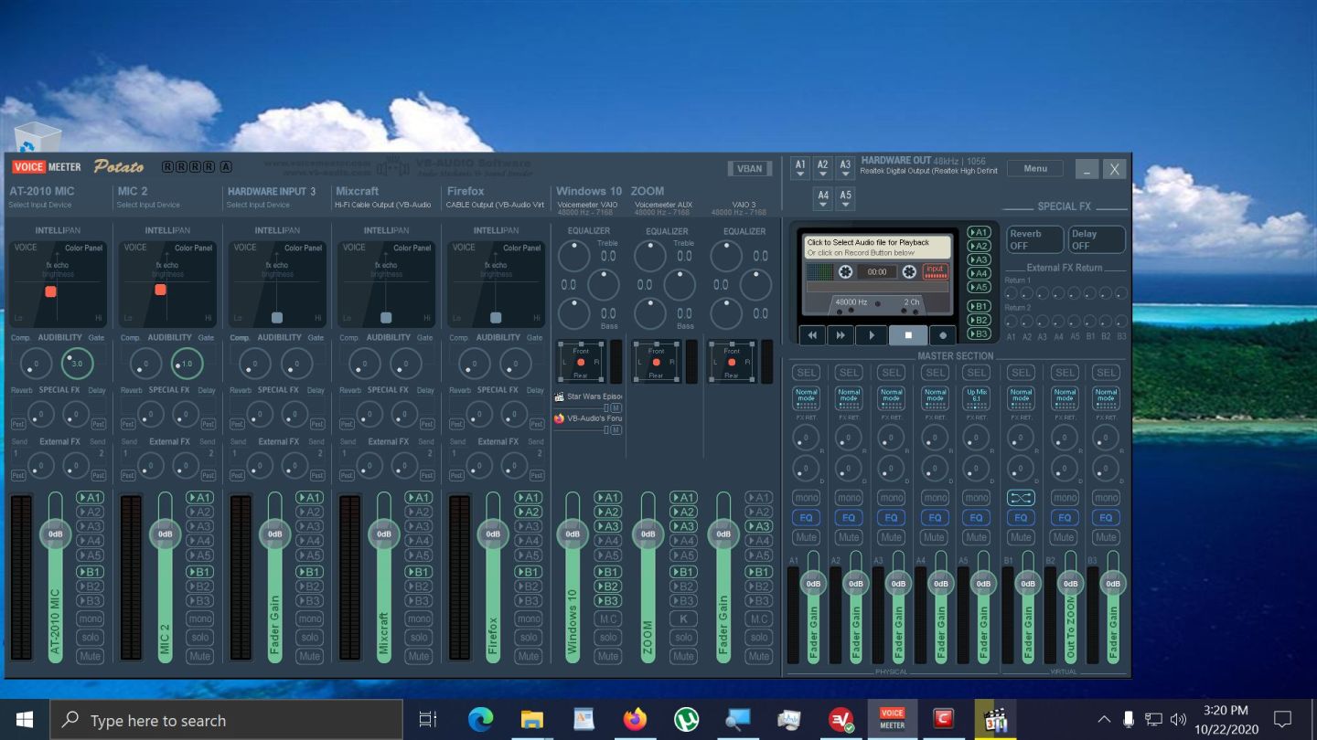

I experience a strange cut of the vital portion of Voicemeeter Potato window. My laptop's screen is too small (1366x768) to render the entire Voicemeeter window. This is what I get sometimes:
On the right side, one can see an underlying Chrome window with some page opened and on the bottom right side of the picture, the usual icons of Windows OS are shown. Since the screen resolution is quite low, in order to operate Potato I must move the window around the screen.
On occasion (usually when the audio engine stops and I have to restart it), I get surprised by what you can see above. No "menu" button and can't perform anything except shutting down Potato completely and restarting it from scratch. Did anyone of you experience anything like that?

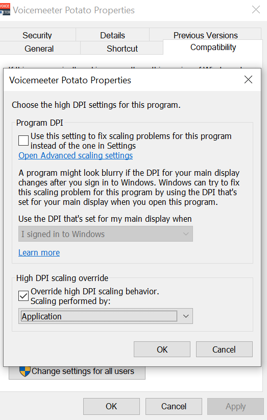

Post by TheVoice »
I use a 1920x1080 screen and this is what helped me.

Does it mean you set up the scaling as in your snippet (two posts up)?
I set up the same on my laptop and have yet to see if it changes anything in my case.

pswiatki wrote: Thu Oct 22, 2020 11:39 pm Does it mean you set up the scaling as in your snippet (two posts up)?
Yes. Just like the picture. Override high DPI scaling behavior is checked and "application" is selected from drop-down menu. Just make sure it's for Potato and not the others (ie., it needs to be the Potato executable or the shortcut to it). You could also try "system" and "system enhanced". I also have scale and layout set to 150% in Windows display properties. You can check that setting as well, but I fixed it with the above solution.

Re: Potato window render issue
Post by pswiatki »
OK, thank you so much for this confirmation. I set up my Potato with the same settings and so far so good. Have not seen a truncated Potato window since. Will see if the issue is gone.
