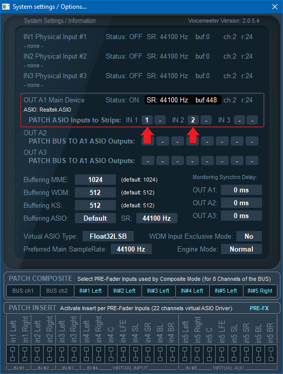

When you select the ASIO option at A1, you can use the System Settings / Options.. window to PATCH ASIO input to Strips. This way you can "patch" the ASIO Input 1 to Hardware Input 1 and the ASIO Input 2 to Hardware Input 2.
ASIO could reduce the latency compared to MME or WDM; you have to try with the different buffer sizes.

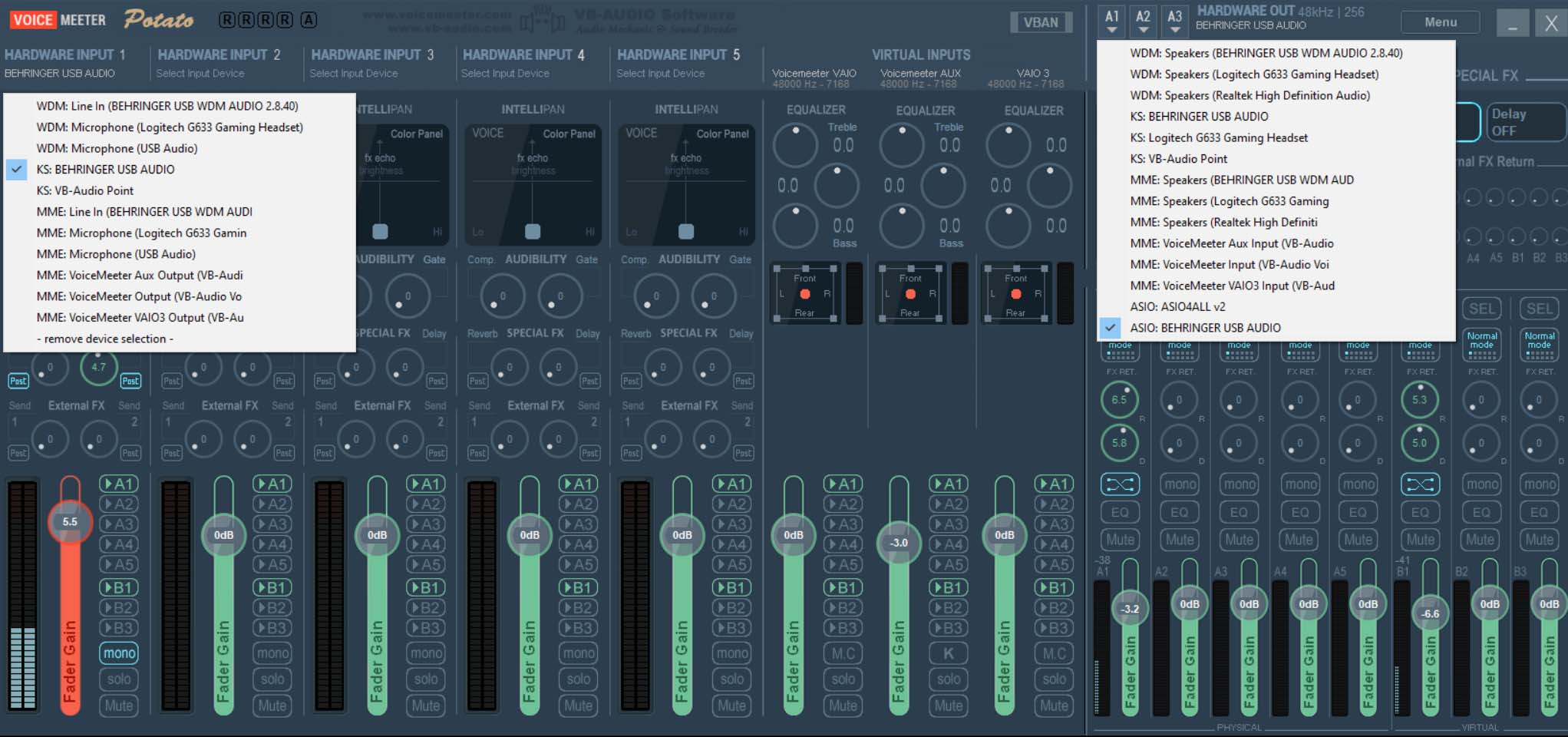

Hi Andres, thank you for the reply. For some reason the ASIO drivers are not available for the A1 hardware INPUT, but they are available--and work--for the A1 hardware OUTPUT (see attached screenshot). Why are ASIO drivers not available for input? Am I missing something?
Thanks again.
Thanks again.

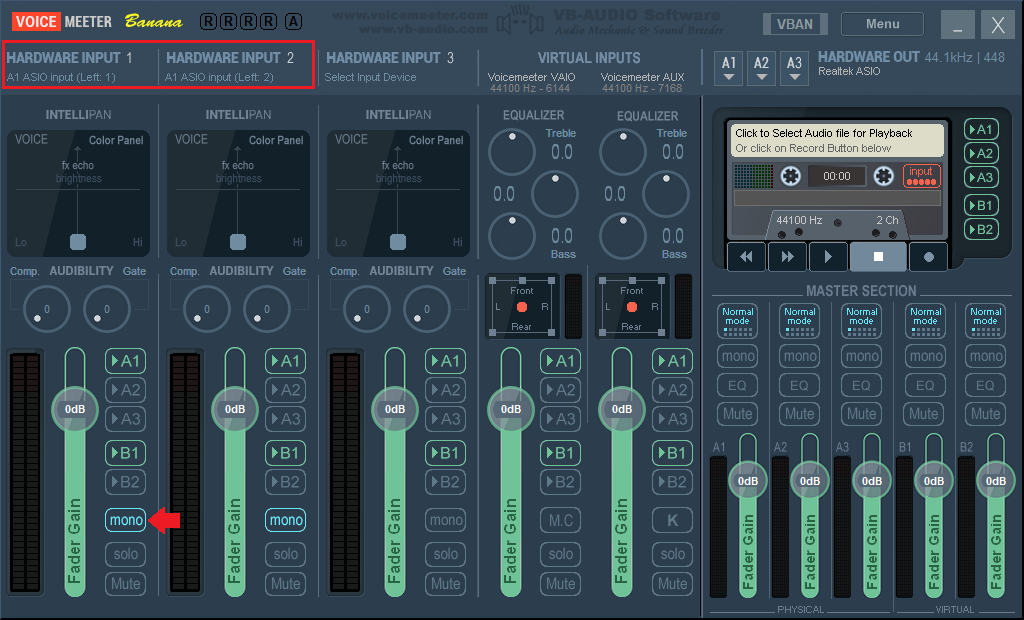

Hi. Voicemeeter does not allows you to choose ASIO from Hardware Inputs selection list. To use ASIO at Hardware Inputs you should try this:
- Choose - remove device selection - from the desired Hardware Input selection list (It is be the last option)
- Select System Settings / Options... from the menu and look for PATCH ASIO Inputs to Strips. To the right of each INput you can select which channel of your interface is connected to the corresponding Hardware Input
It looks like this (I am using Voicemeeter Banana)
- You should see the ASIO Input appears under the Hardware Input
- Optionally activate the mono button in each hardware input to duplicate the signal to the left and right channel

Suggestion 2 works! It separates the UM2's two hardware inputs (mic is in 1, instrument is in 2), and the latency is manageable.
On a hunch I restored the 48khz simply by rebooting my PC.
Thank you again VERY much for your help!
