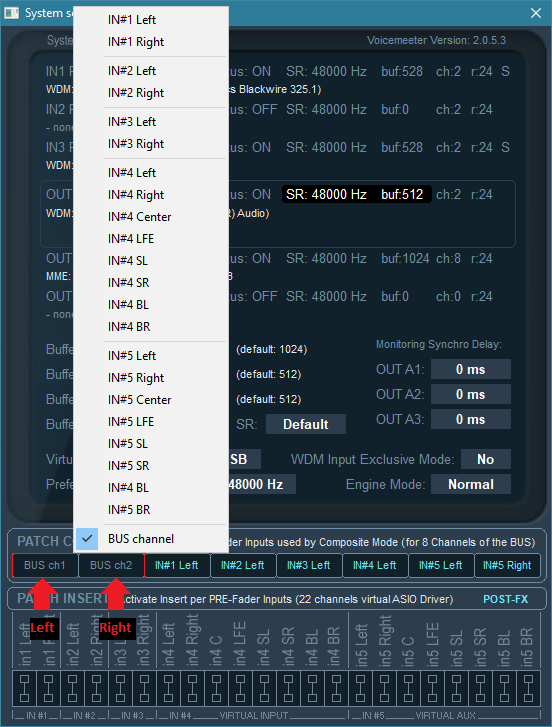

I'm looking for a way to output the signal from two different (mono) sources as L/R in one channel.
Usage case: output two separately equalized (mono) signals for 2 subs as L/R of one line out.
Does this make sense?

Hi. Voicemeeter MASTER SECTION allows you to select a different routing mode for each of the output busses (A1,A2,.. and B1, B2...). Composite mode allows you to compose the 8 channels of the busses using any of the input channels (PRE-Fader or POST-Fader).
Voicemeeter System Settings / Options... window includes a PATCH COMPOSITE section to set the channels up.
The first two channels of the output bus correspond to L/R. Select the desired mono inputs:
composite l+r.png (57.12 KiB) Viewed 3498 times
Please let us know if this could be a solution to your issue.
