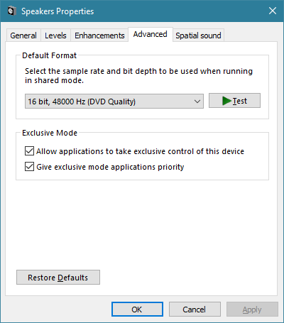

Hi. Apparently Exclusive Mode has been disabled on the Speakers (Sennheiser) properties. Go to Sound control panel - Playback - Right click the Speakers icon - Choose Properties - Advanced tab - Enable both checkmarks in the Exclusive Mode section:
Exclusive Mode.png (9.9 KiB) Viewed 38156 times

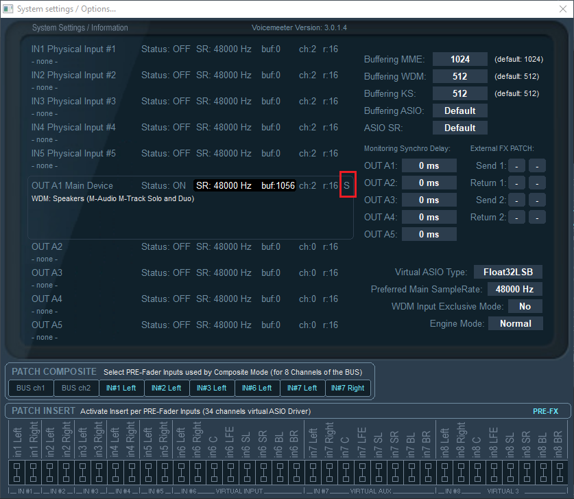

Voicemeeter will use your WDM output devices in Exclusive Mode. This avoids other applications to use the device at the same time. In contrast, MME uses the output device in Shared mode (other applications can use it simultaneously).
The S at the end of the A1 device in the System Settings option denotes the device is being used in shared mode. It is only applicable to WDM.
Shared Mode.png (86.28 KiB) Viewed 38156 times
Hope this helps. Let us know if you need further assistance.
