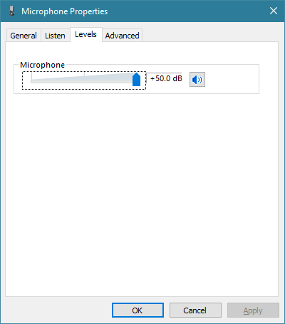

Hi. Typically Windows will provide a gain control for recording devices in the Levels tab of the Properties window in the Sound control panel, similar to this:
microphone gain.png (5.35 KiB) Viewed 45887 times

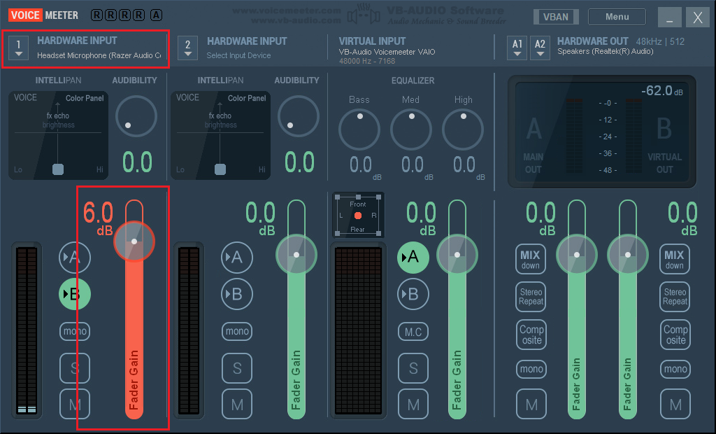

To connect a microphone to Voicemeeter you can use a Hardware Input. Clck for example over Hardware Input 1 and choose the desired device. You typically have 2 options: WDM and MME. WDM is newer so try that first. Use the Gain Slider to add some gain to the level of the microphone. Similar to this:
Microphone Selection + Gain.png (168.98 KiB) Viewed 45887 times
Turn on the ►B button on the selected Hardware Input to send the microphone audio to the Voicemeeter Output. Select Voicemeeter Output as your microphone on the desired application.

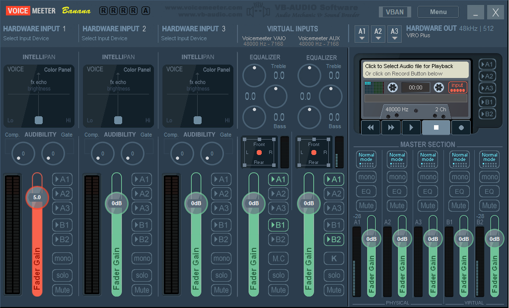

Thank you so much! My question is- if in VM Banana I have my normal audio (which in this example is a game) set to A1 and B1, and VM Aux (which is discord and music for example) set to A1 and B2, then am I supposed to set my mic (Hardware Input) to B1 only? Will it then be somehow recorded to my track in OBS as this "game" track or will I hear my voice as a playback all the time? Sorry, can't explain. I'm attaching my VM Banana Screenshot.
Thank you so much for your reply
VM Banana.png (134.9 KiB) Viewed 45885 times
