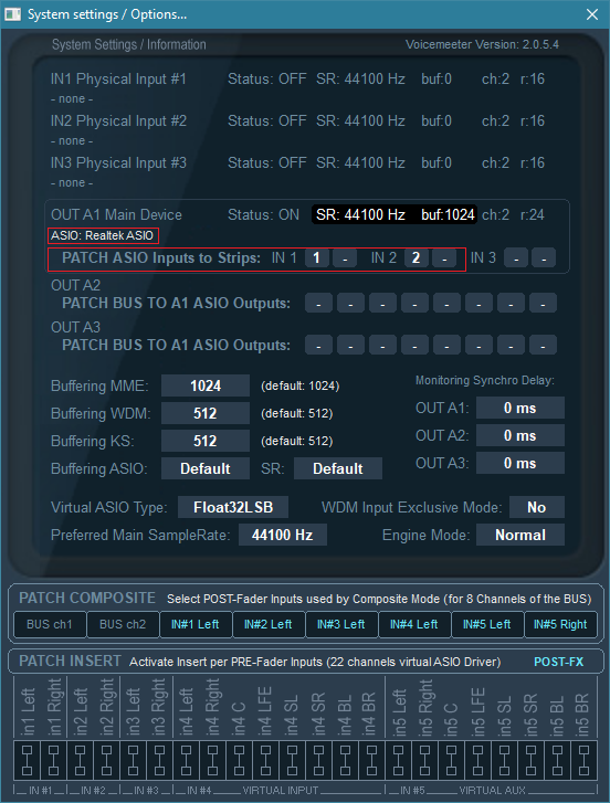

Hi. Voicemeeter includes ASIO support which is typically used with USB audio interfaces. You may have a look at this tutorial: https://youtu.be/35N8hkOy8h4
Start by selecting the ASIO option for your interface at Hardware Output A1. Then use PATCH ASIO Inputs to Strips to connect the appropriate channel to the corresponding hardware input.
ASIO A1 - PATCH ASIO Inputs.png (71.06 KiB) Viewed 9789 times
Please remember to - remove device selection - from the Hardware Input in which you want to connect the ASIO channels.
Please let us know your results. We will be happy to try to help you with your issue.

Thank you so much! I had no idea I could route audio like that in Voicemeeter. You have no idea how much stress this takes off me. Teaching remotely is so much easier with Voicemeeter. I cannot thank you enough. Stay safe!
