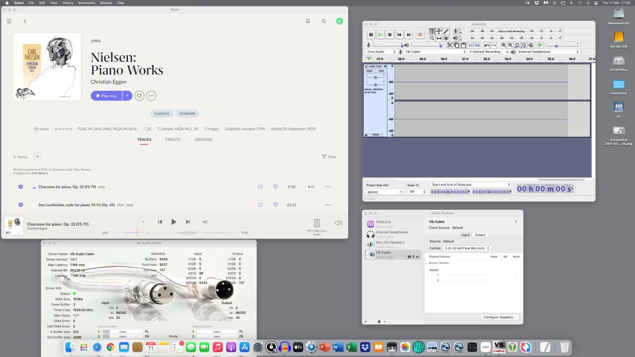

I have a 2018 MacMini running Big Sur 11.3.2. I have installed the most recent version of VB-Cable. The Control Panel of VB-Cable opens up correctly.
I would like play back an MQA file (which I purchased) with Roon and then record the unfolded MQA file with Audacity.
I set up all the programs to 88.2kHz, as that is the playback sample rate of the MQA file in question. This is a screenshot of the settings:
Screenshot 2021-03-11 at 17.05.08.jpg (101.33 KiB) Viewed 43122 times

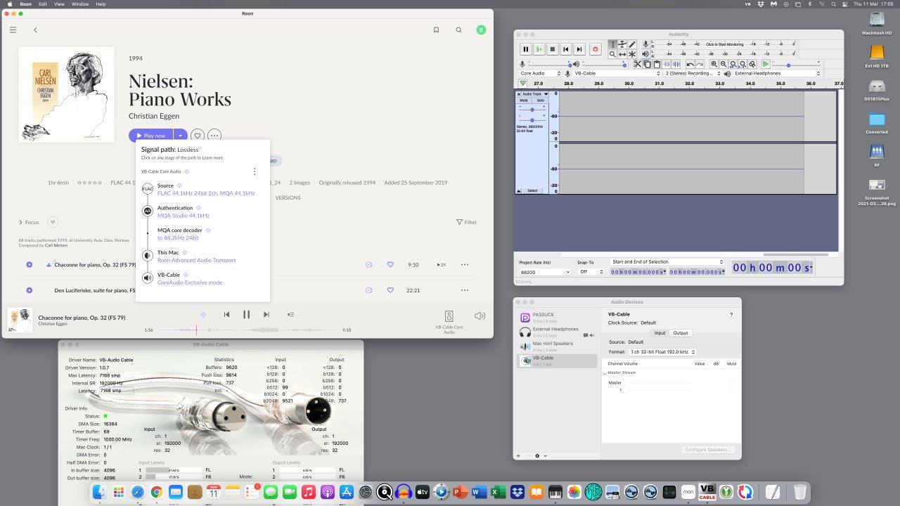

As soon as I start playback on Roon, VB Cable switches to 192kHz. Audacity on record does not receive anything.
Screenshot 2021-03-11 at 17.05.30.jpg (104.68 KiB) Viewed 43122 times

assuming you have intel Mac Mini, (not M1).
i don't see any value on your screenshot... but it seems the capture doe no work
did you click on RECORD in Audacity ?
maybe you have to increase VB-CABLE internal latency of the cable to 16K

Yes, I have a 2018 MacMini (Intel).
The top screenshot shows the configuration BEFORE Roon starts to play. VB-Cable is set to 88.2kHz both on input and output.
As soon as I press play in Roon (and Roon actually starts playing at 88.2kHz), VB-Cable switches to 192kHz both on input and output. This is shown in the second screenshot. And yes, I have clicked on record.

The first one shows the settings of VB-Cable Control Panel when adjusted do 88.2kHz through Audio MIDI Setup. VB-Cable is set to 88.2kHz, as playback of Roon will be at 88.2
The second one shows the Roon interface during playback. It is playing back at 24/88.2kHz.
The third one shows the VB-Cable Control Panel after Roon playback has started (at 24/88.2kHz). At the instant playback starts, VB-Cable Control Panel changes from 2 Channel 88.2kHz to 1 Channel (!) 192kHz.
Re: VB-Cable on Big Sur?
Posted: Mon Mar 15, 2021 10:14 am
Well, the cable is made to connect 2x applications together (a player to a recorder).
so on the first ControlPanel, i see only one application connected to: the player is sending audio with 4096 sample buffer size.
ok but you have no capture application connected to the output of the cable...
Posted: Mon Mar 15, 2021 2:19 pm
by jacobacci
I had connected VB-Cable to Audacity at the other end. I have now found out that Audacity was set to 1ch (mono) instead of stereo. That seemed to throw VB-Cable off course.
I have now set Audacity to stereo and everything works fine.
