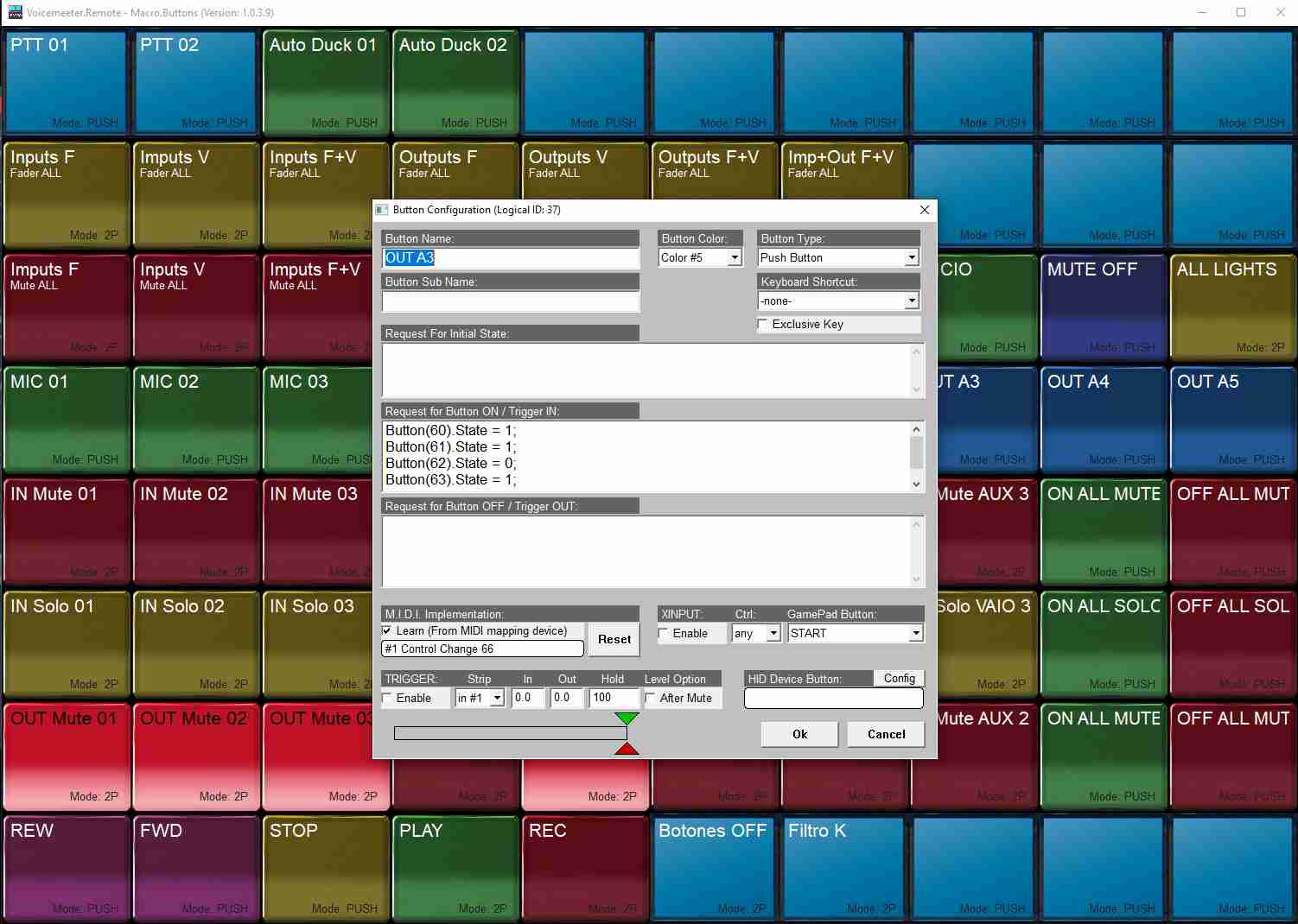

I had the same problem that MacroButtons could not use the same MIDI interface and I have MacroButtons and VoiceMeeter working at the same time with the Mapping on the FF button.
01 Macro ButtonsExp.jpg (98.45 KiB) Viewed 18233 times

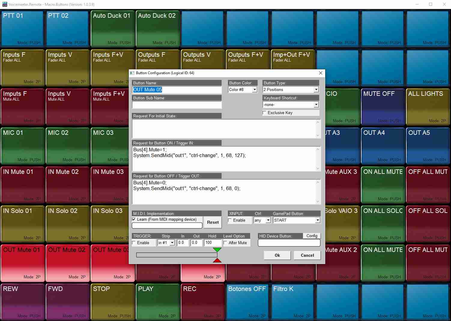

Solution remove the output from M.I.D.I. MacroButtons and mutes and I only have them with the code indicated in the MacroButtons documentation for example:
Strip (2) .mute = 0;
System.SendMidi ("out1", "ctrl-change", 1, 50, 0);
02 Edit MuteEzp.jpg (92.89 KiB) Viewed 18233 times
Then I have the button that does the action with a link to the example button:
Button (60) .State = 1;

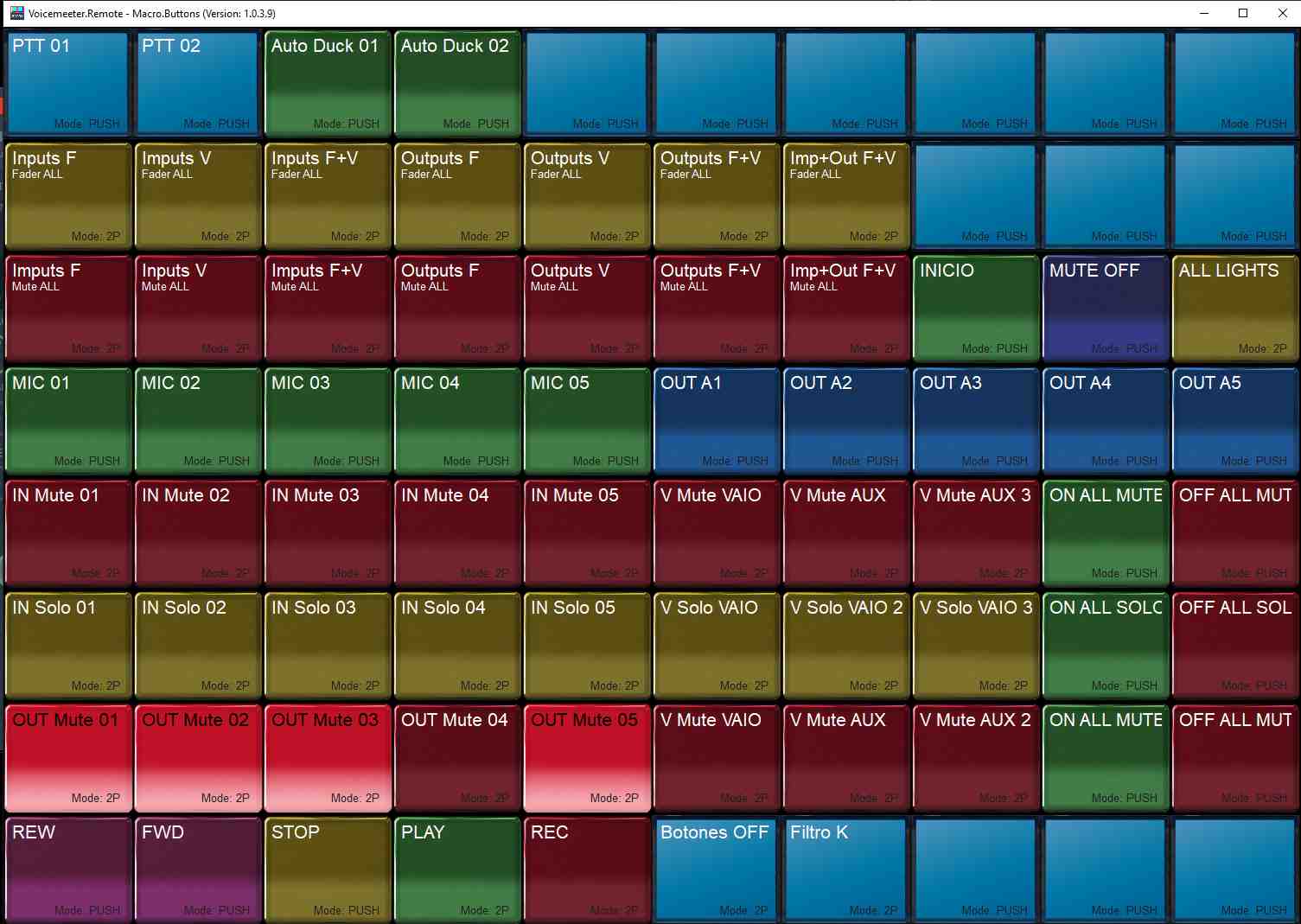

And with M.I.D.I. Read the button and with this configuration I get both things to work, I have in the outputs that pressing one output activates that one and all the others are muted, to see if this can help someone.
