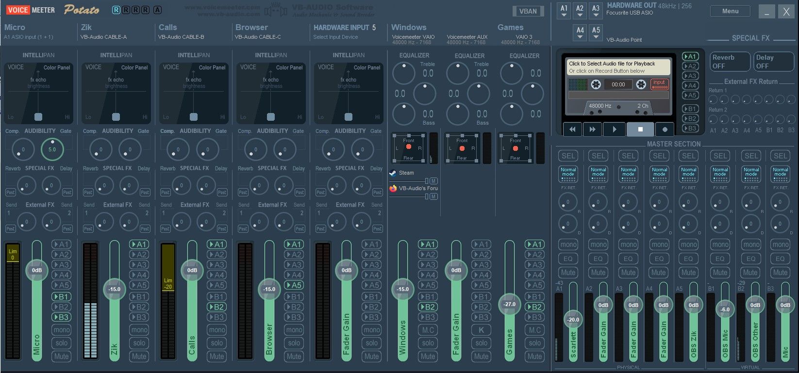

My setup is as follows :
- USB audio interface, Focusrite Scarlett Solo 3rd gen
- Input 1 : microphone (more on that below)
- Input 2 : Music, through a virtual cable from my music apps
- Input 3 : Calls (Discord, Skype, Mumble), through a virtual cable from such apps
- Input 4 : Brower, through a virtual cable
- Input VAIO : Windows default
- Input VAIO 3 : Games, through Windows Advanced audio settings and setting it as output
- A1 : Focusrite ASIO
- A5 : virtual cable toward OBS for music
- Output VAIO : Mic to OBS
- Output AUX : Other to OBS (Windows sounds, games)
- Output VAIO 3 : Mic to everything but OBS (Discord & co, voice recording, etc.). That's my default Mic input in any app except OBS

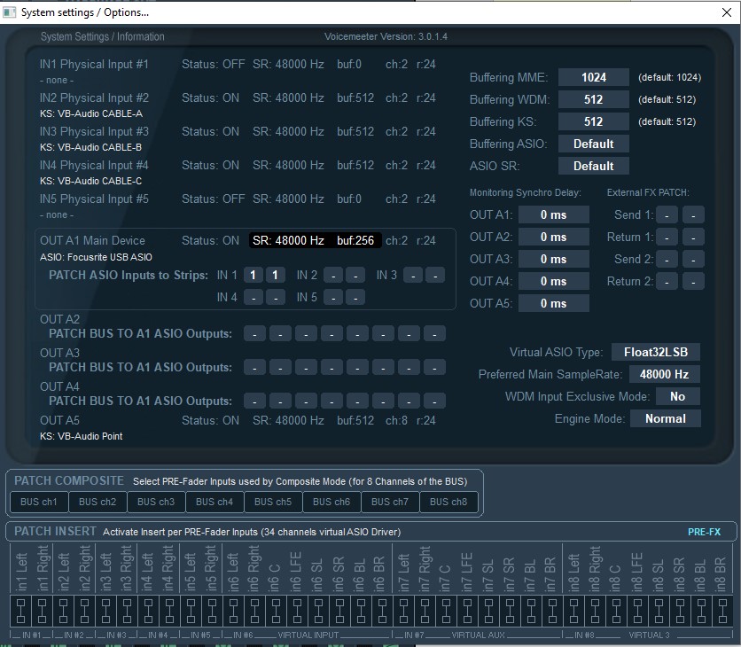

I actually found quite a few things to sort out :
- consistency between all elements of the audio chain, regarding sampling and bitrate
- audio interface buffer
- uninstalled everything and restarted from scratch, with reboots between each installation (Voicemeeter, Audio cables), since apparently Windows 10 updates were bound to mess things up sometimes
But, more recently and more importantly, a major breakthrough/realization, when like 3 weeks ago I found out that I was using the KS entry from my Focusrite to input on Input 1. Big mistake, as you experts will probably immediately see, so instead I obviously setup the PATCH ASIO feature, and things started to look better for a couple weeks. No crashes at all from March 14th until March 31st, and I was sure I had it sorted.

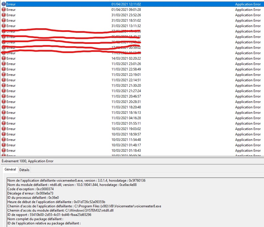

In Windows' Event log, those striked are not voicemeeter crashes. All the others are.

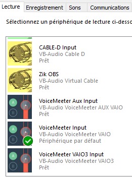

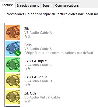

Playback devices

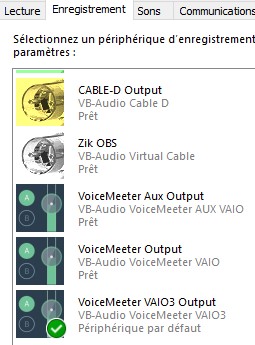

Recording devices
