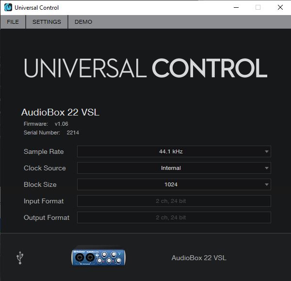

USB Audio interface:
Presonus AudioBox 22VSL
Latest version of driver (Universal control 3.4.2.63992)

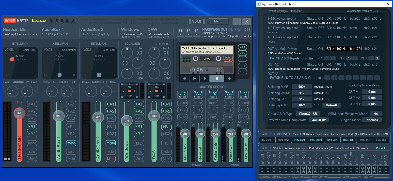

Voicemeeter Banana set up:

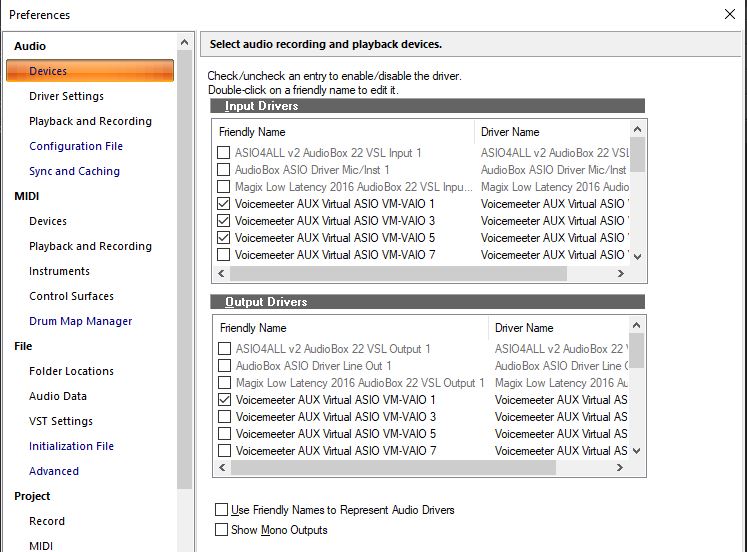

DAW
Cakewalk by Bandlab ver. 2021.01, build 098, 64 bit.
Device preferences:

one pre-requisite to guarantee a stable stream on a DAW connected to Voicemeeter Virtual ASIO driver
is to have a buffer size above 5ms on the Voicemeeter main audio stream (so at least 256 sample buffer size at 48kHz for the output A1 device - and 512 samples if not stable enough with 256 samples).
One test you could perform to check that the problem does not come from the stability of your ASIO device (physical one)
Simply select a WDM internal Audio board as output A1 and you will see if you get the same behavior.
LAST WARNING about Presonus Audio Box: it seems there is a default on firmware side, they crack on peak:
https://forum.vb-audio.com/viewtopic.php?f=11&t=1598
