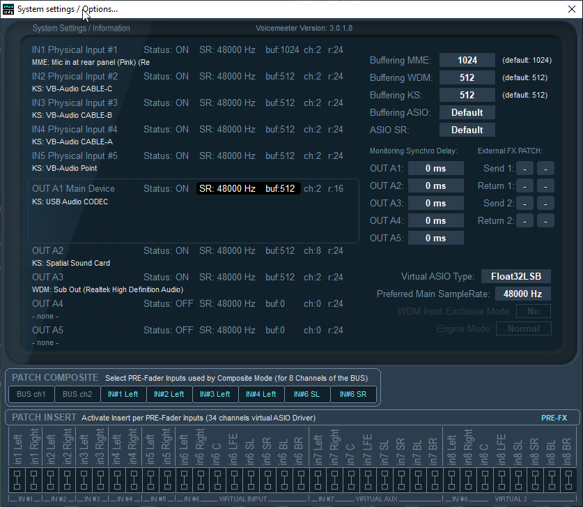

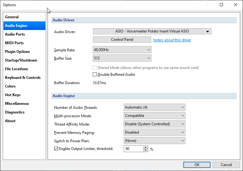

my insert bus is having problems on cantabile 3.0 lite while acting as insert bus unit, voicemeeter other functions work fine and audio is good, what can I do to troubleshoot this, I reinstalled to no avail, rebooted once after de install then again after install, also reinstalled the cables but nothing changed, attached voice meter settings and also cantabile 3.0 settings, any idea of what I could try

it seems i found the problem ks audio buffer was not high enough set if from 512 to 768 and working now, I wonder why though maybe anyone can shed a light in the mistery

Try a more reliable device as your A1 output. I strongly recommend nvidia HDMI or DP outputs if you don't have some kind of pro audio sound card.

i also found adding more "buffer" from default to max helps it now I need to find the lowest my devices can go as my monitors don't have a plug and because of that I cant trick nvidia to enable their devices

did a complete re-install(12 reboots, one for each un install and re install) and I managed to get MME to be more stable on 1024 but atm I cant manage to get WDM to do so atm), idk if re installing my soundcard drivers(Realtek) would assist in that, edit mme is not stable still on 1024, had to change to 2048 to get it working proper, if you have an idea of what I can do to maybe get better results just say, I cant atm enable monitor audios as none have a slot to plug things in)

At the least, your onboard audio card (probably a realtek) should probably be able to keep things working OK with the default buffer sizes. The nvidia one I mentioned is nice if you have the ability to use it, but that's just one example. Really, we just want to use something that is not USB.
