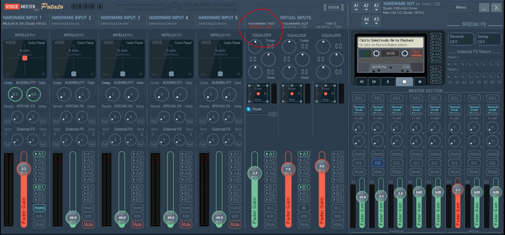

I was trying to get my sound to quit stopping intermittantly and was experimenting with everything including uninstalling Voicemeeter Potato 64bit. I had changed at one point the samples from 7168 (recommended) to a lower samples number. I have tried everything I know how to try and get it back to the 7168 number. Everytime I open Voicemeeter on a fresh boot the samples number under Voicemeeter VAIO is 768. Any help would be appreciated.
Voicemeeter VAIO problem.JPG (223.69 KiB) Viewed 10939 times

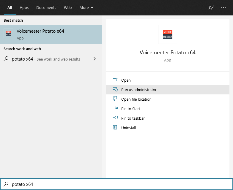

Hi. Please try this:
  • Run Voicemeeter Potato x64 as an Administrator
  • Change back to the recommended value (7168 samples) by right-clicking the current value
  • Shutdown Voicemeeter and open it again normally (Without running it as Administrator)
  • Restart Windows to test the new setting persists
Voicemeeter Potato x64 - Run as Admin.png (43.52 KiB) Viewed 10931 times
