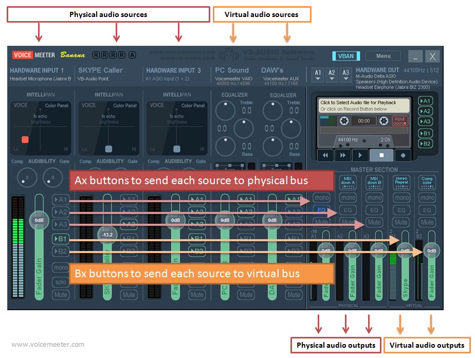

Voicemeeter Virtual AUX output is fed by the output BUS B2
if you send nothing in B2 (see assignation button on each strip) you will get no audio in AUX output.
- VoicemeeterInternalRoutingDiagram.jpg (133.92 KiB) Viewed 64117 times
