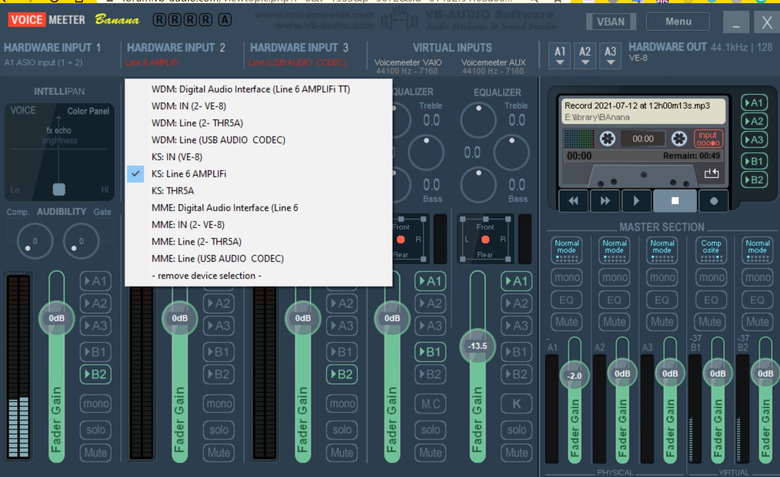

No differently than the post above, I still get the Input 2(KS driver) and 3(WDM) disconnected now and then, especially after some inactivity. Using autorestart Engine does not help. Manually restarting the VM engine works though!
Also I have trouble using multiple Outputs in Ableton, how do I map Output 2 to Ableton 3-4 output?
I tried playing with the matrix 8 but couldn t find how to map left-right of the Output 2 to Ableton Voicemeter Virtual ASIO to Ableton 3-4 output.
There are 4 double Outputs in Virtual ASIO appearing in Ableton, what do the map to ?

I do experience disconnects at points as well - in my case this is either due to a blip in available sound devices changing (e.g. PS4 controller that re-connects) or whenever I cycle my TV power. The only work-around for this as far as I know is to disable sound devices you don't actively use - or if there is a problematic device that disconnects and re-connects randomly, troubleshooting for that specific driver/device.
As for your output mapping - I am not particularly familiar with Ableton so this is the best I can do:
- Select your Ableton device for either A1, A2, or A3.
- Either use Stereo Repeat (below SEL, click the cluster of dots to cycle through it) or use the 8x8 Matrix to map your desired inputs to the correct channels.
- If you need to map multiple outputs (e.g. A1 and A2 at the same time), take a look at my extended version of the 8x8 Matrix:
https://forum.vb-audio.com/viewtopic.php?f=6&t=1503
Let me know if any of this helps, if you cannot solve it, I'd be happy to try and help you directly.

I found the Wdm devices disconnect red at every remote desktop connection. Vnc viewer is the workaround.
I use Composite input mapping. Works great.
I will check the multiple output matrix, but how can I achieve the same of Composite for the output interfaces coming to Ableton. What do the outputs 3 to 8 map to? The matrix?

Finally I got it stable.
The Windows sound control panel freezes, and defreezes when I shut down Banana.
Ableton was giving and still gives an error 'serious error has occured and Ableton will now close'.
The solution, also to the audio cracks was to start Ableton before Voicemeeter. If I shut down Ableton and don't close Banana before restarting I get either audio drops and crackles in my recordings, or Ableton crash with the above error.
I am now using a KS driver as Output because its brother ASIO was blue screening my windows at times.
Also as mentioned previously using a RDP connection, even with device redirection disabled, will disconnect 'red' the WDM devices, so using VNC to remote into your DAW is a better option.
Wow! What a trip.
ThanksBanana
