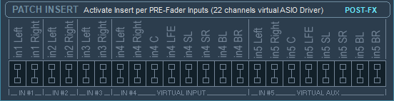

To use Voicemeeter Insert Virtual ASIO, select that device in the Ableton settings. That driver will provide 22 Input / 22 Output channels that correspond to this in VoiceMeeter System Settings / Options window:
Voicemeeter Banana PATCH INSERT 22-channels.png (9.72 KiB) Viewed 16152 times
Once you select Voicemeeter Insert Virtual ASIO Ableton will receive audio from Voicemeeter; to send audio back from Ableton to Voicemeeter click the small square boxes in the desired channel.
