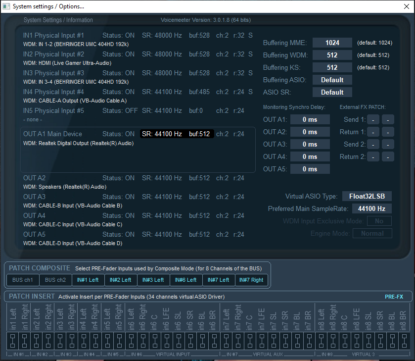

Hi. A general recommendation to avoid choppy audio is to select a physical device at Hardware Out A1 (like MME: Speakers or a headset); A1 is Voicemeeter main device so when possible use a physical device. You can also share a Voicemeeter **Menu > System Settings / Options...** window screenshot to take a look.

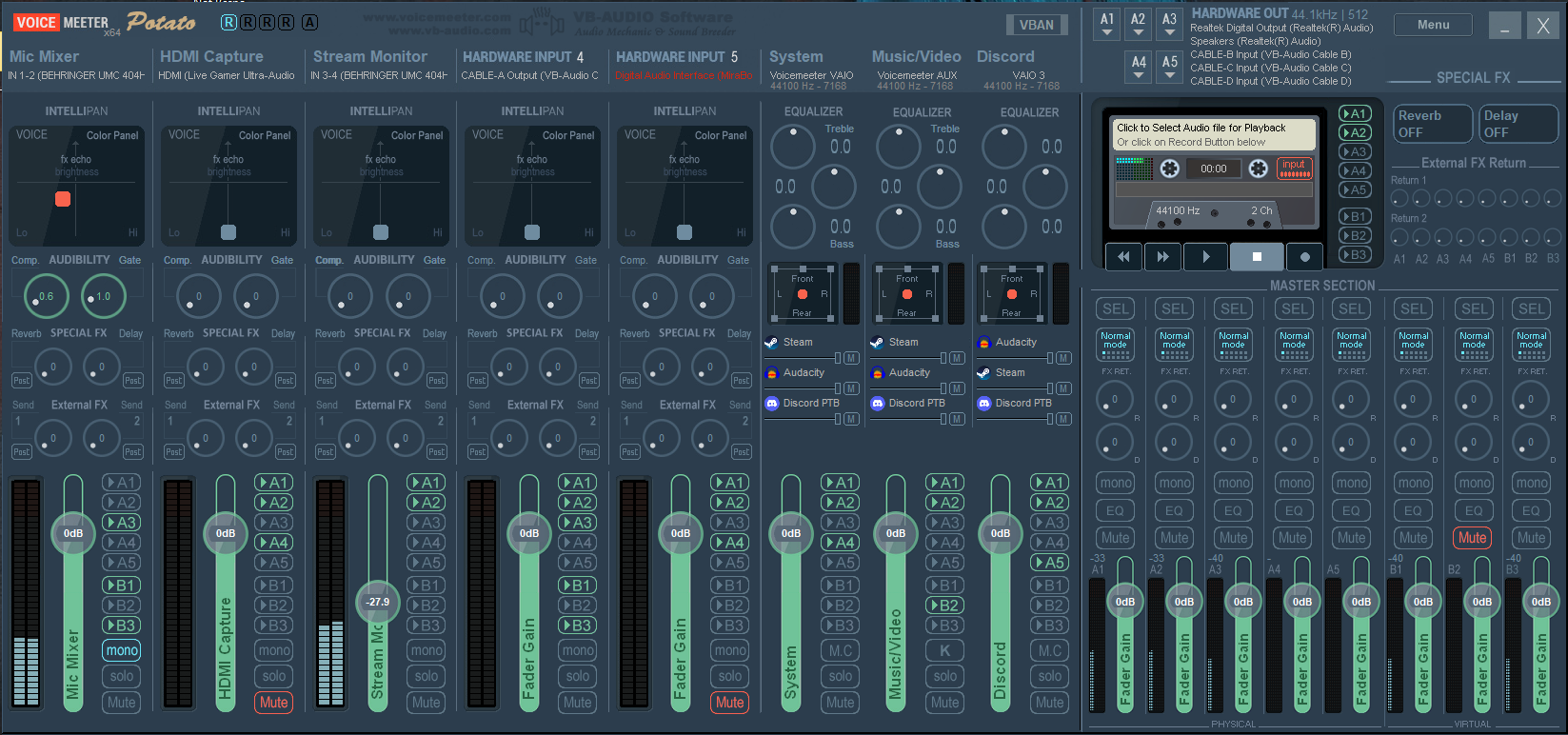

So, basically the Virtual Cables are not a good output for VoiceMeeter. Below is a screen shot of the data requested, the VoiceMeeter setup, and an Image showing the audio.

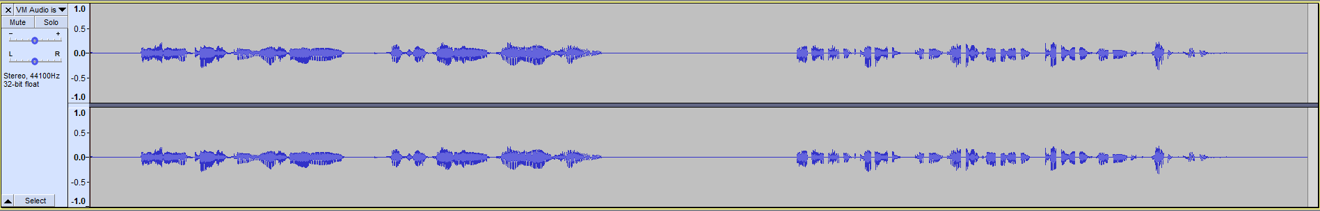

Here is an image of the audio. The first half is using the VoiceMeeter VAIO output into Audacity. The second half is through a Virtual Cable into Audacity. The main reason I want to use the Virtual Cables for outputs is for recording. I can have the system audio going out one, my mic on another, music one another, and my Discord audio on one. If I have everything going through one output, then it makes it hard to adjust after the fact.

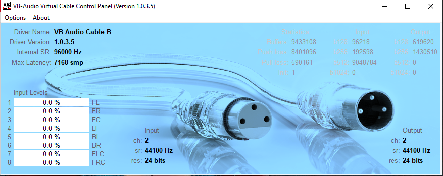

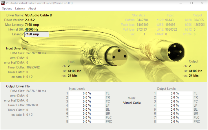

Looking at the control panels, it looks like they are already set to the Max Latency (not sure if this is the Internal latency) of 7168 and the output Sample Rate is 44100 Hz.

- Posts: 2194
Re: Audio Choppy when using Virtual Cables
The first virtual audio cable control panel shows and internal samplerate at 96 kHz, please set it to 44100 or 48000:

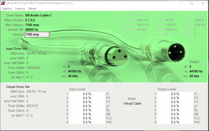

I did test with Virtual Cable C (which appears to be set at 48000 Hz, I have not tested 44100 Hz yet with it) and it is also being choppy with Audacity. I also noticed all of the outputs were choppy when I reviewed my Twitch recording (this was recorded by Twitch as I streamed).
