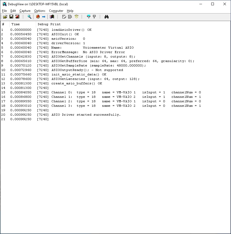

I am a minor (very minor) contributor to Thetis, an open-source software defined radio transceiver application used by ham radio operators around the world (openhpsdr.org). We are having trouble writing code to interface our application's receiver audio output stream to the Voicemeeter Virtual ASIO driver. The OutputDebugString() dump (shown below) indicates that we are successfully loading and initializing the driver, but our code can't seem to pass audio:
Our code is successfully streaming audio to other common ASIO drivers (e.g. UMC ASIO Driver, Studio 192 ASIO, Focusrite USB ASIO, ASIO Lynx, etc.), so I was wondering if there's something special about the Voicemeeter driver that we are not addressing? Or maybe there's an SDK we can take advantage of? Advice please?

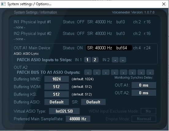

could you please post a screenshot of Voicemeeter System Settings Dialog box?
Voicemeeter is usually not able to synchronize its virtual ASIO driver below 128 sample buffer size.
we recommend to use 256 samples buffer on Voicemeeter main stream to get a secure and stable audio stream on our virtual ASIO device.

Here is the settings dialog box:
I will try having our application initialize the Voicemeeter virtual ASIO driver to use 256 sample buffers, to see if that helps.

yes, 64 sample buffer is surely too small. you may start with 256 or 512 samples buffer on Voicemeeter Main Stream.
(basically 5ms has to be considered as a minimum time cell under windows for getting stable real time audio).
Also you have defined the Virtual ASIO TYPE to Int32LSB which an option for old app . Today everybody uses Float32 instead.

I can see that ASIOStart() is returning ASE_OK from your virtual asio driver, but our bufferSwitchTimeInfo() callback is never called by the virtual asio driver. Are there additional handshaking steps that are needed to get the stream started? Can you suggest any driver inquiry calls that I can make to troubleshoot further?
