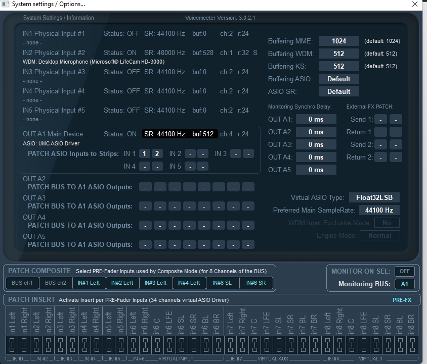

Please select the Menu - System Settings / Options... option and share a screenshot.

I've attached an image of the options.
When playing back an MP3 in the integrated recorder with the UMC204HD ASIO setting as the A1 output I get the same issues.
The artifacts do vary with the selected sample rate in the 204's control panel, but are present in regardless of the buffer size.
