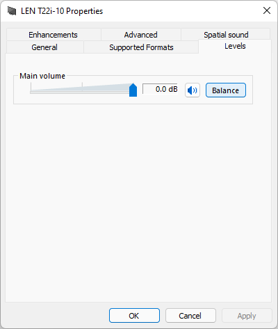

Re: 3 Speaker separate with L/R setting
Hi. As an alternative in the meantime You can explore using the Balance control exposed in the Levels tab of the Properties window for the monitor in the Windows Sound control panel. My monitor is connected via HDMI to an AMD graphics but I assume nVidia will also support that.
HDMI Monitor - Properties - Levels.png (7.96 KiB) Viewed 19489 times

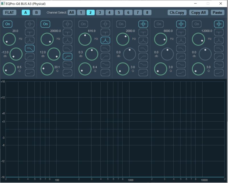

@Andres my walkaround atm for pan on BUS Output is to use the EQ for it.
Combine a Highpass and Lowpass on Channel 2 to cancel it out completely for A1 and only Channel 1 (left signal) should remain.
Same on Channel 1 for A3 and only right channel remains.
Here i have it done on A3 to output only chanel 1 (left), so my normal EQ settings for this speaker is still on channel 1.
Screenshot vbaudio_pan_with_eq.jpg (54.98 KiB) Viewed 19453 times
