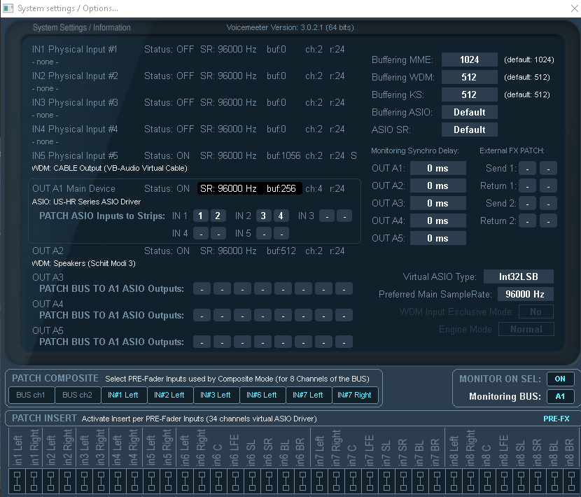

could you post a screenshot of voicemeeter system settings ?

Post by D10wrangler »
Here is a Screenshot of the system settings
Potato System Settings
Posts: 2209
Re: Problems using Tascam US-4x4HR
ok, so while Voicemeeter is using the ASIO driver, maybe no other application can get access to it ...
that's why Voicemeeter provides Virtual ASIO driver to connect your DAW to Voicemeeter.
the Virtual Potato ASIO Insert driver is recommended for recording workflow with a DAW, because you get access to all Voicemeeter input channels (pre-fader).
