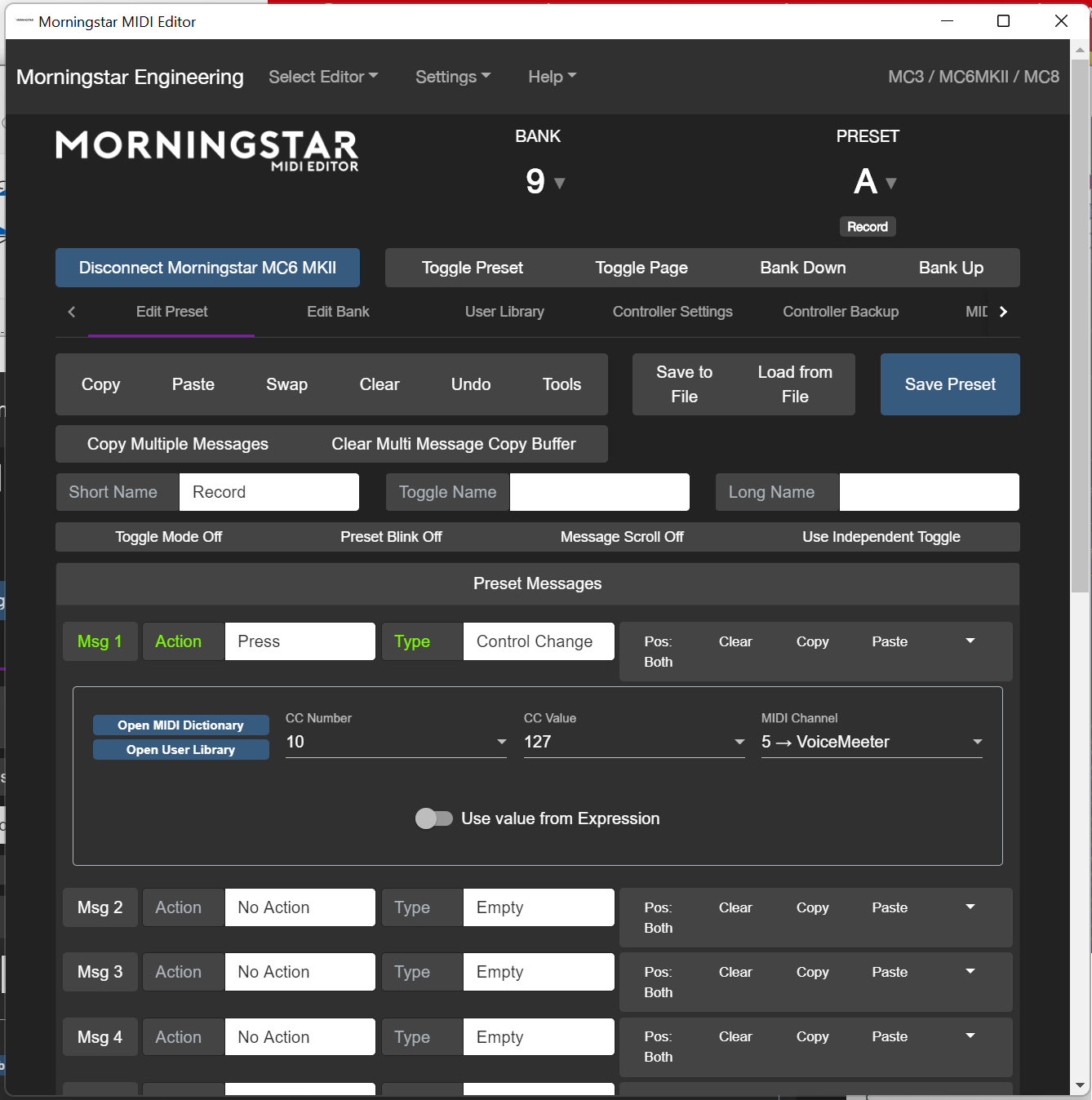

I am wondering whether anyone has had any success sending a CC message from a Morningstar MC6 (or similar) to control the Voicemeeter Potato Tape Recorder. With the MC6, you tell it what MIDI message you want to send when a button is pushed and to which MIDI channel. You can also send Sysex messages.
I've arbitrarily decided to use channel 5 (as I have other devices on channels 1-4) and decided on sending a MIDI CC 10 with a value of 127 for start record, and a value of 0 for stop record. This is basically the same way (different codes) other pedals do it (ie my FM3 or Aeros Looper).

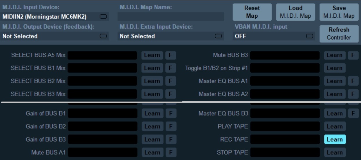

So when I start up the MIDI Mapping on VM Potato (x64), I selected port 2 of the MC6 as the input MIDI device, navigate to page 5, and hit the [LEARN] button on the record, then hit the designated button which should be sending CC 10 127 on channel 5. Problem is, nothing shows up in VM.

Here is the setup of the MC6, Bank 9 Button A.
And here is the MID Mapping Page
I had to cut out the middle half of the page otherwise the image file would be too big.
I hit Learn, took the screen grab, then hit Button A on the MC 6, and nothing shows up as it does in the youtube videos suggest it should.
