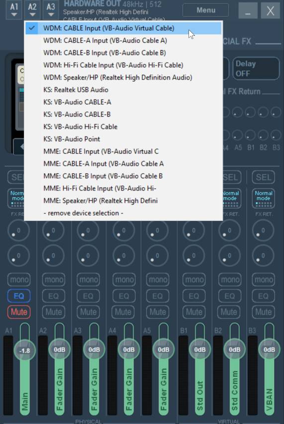

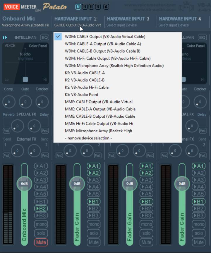

As an alternative, you can use the virtual audio cable that comes with Potato.
You can use that to connect one of Voicemeeter's hardware outputs to one of its hardware inputs.
If I select the VAC's input as my hardware output A2... ...and the VAC's output as my hardware input 2...
... I get a loop from output A2 back into Voicemeeter on HW input 2.
Ragnar
